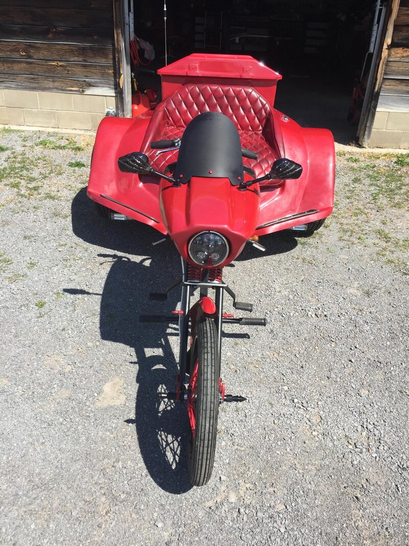

Stires Stallion Updates
yahoo done. :clapping:. Finally completed my Resto Mod restoration.. If it can be described as so. complete rewire to modern electronics. Dropped the body in back by 4 inches, when originaly assembled there was a piece of wood put under the passenger seat mounting location and 2 supports made for the engine cage to hold the body up in the rear. All because they wanted to run a 2 1/2 in. breather filter instead of the 1 1/4 in. one that was supposed to be used. It tucked the body right down to the frame and tires. Looks 100% better.
Full LED conversion. Dropped my full load draw on my battery to about 4.5A. Starting improved drastically with the electronic ignition conversion.
Repainted,buffed and polished as required.
Enough of the yacking here are some photos.
