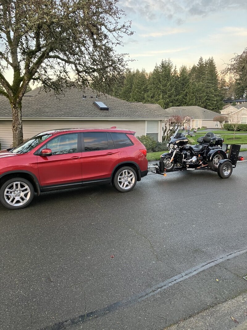

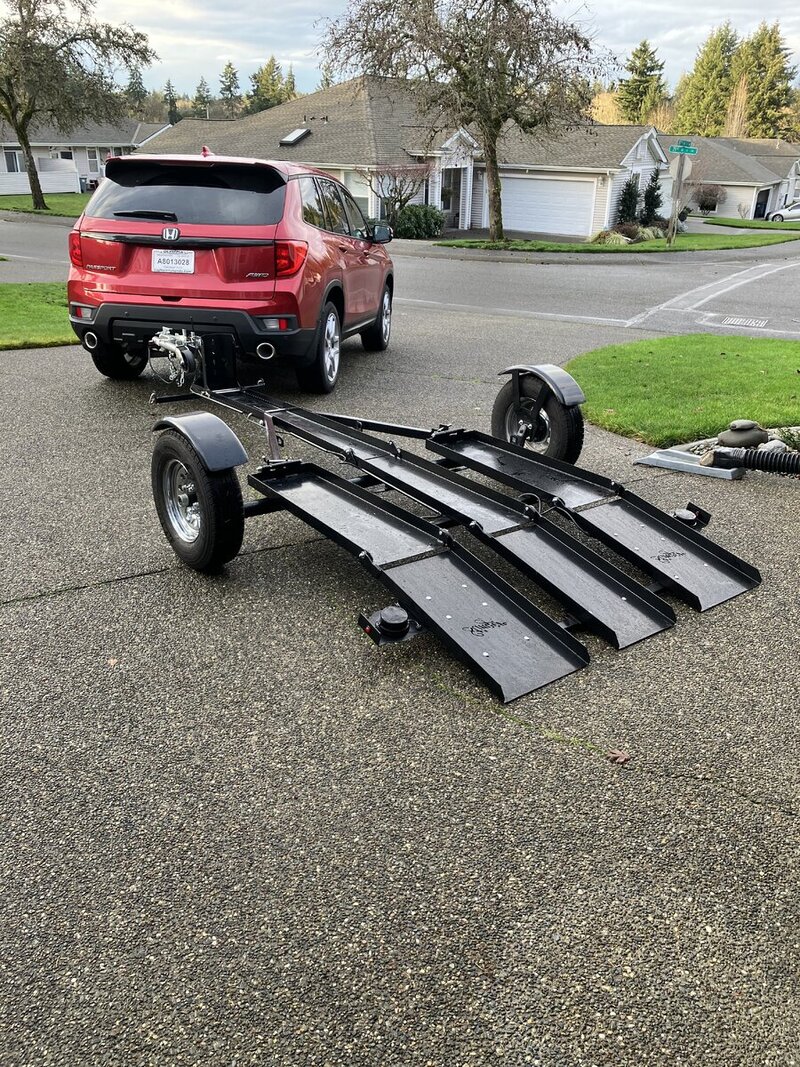

Just bought a stinger trailer for towing the Tri Glide. I towed it empty for approx 200 miles at 70 miles per. It never waivered or swayed a bit. The picture shows 2 spare tires that I tied on to get some tongue weight. Not sure I really needed it but everything was right on.
GVW on the trailer is 2990 trailer weighs 550. Tri Glide weighs 1150. Trailer tongue weight is recommended to be 10-15%
Towing home empty I figured 50# tongue weight to prevent sway. The tires provided that tongue weight. I have just purchased a new vehicle with 5K towing capacity and will be looking forward to giving a report on how it all goes when complete.
I towed home the trailer with a truck, but the new tow vehicle is a Honda Passport. Couldn't believe the Passport had that high of a towing capacity but it does with Honda towing package which includes a tranny cooler.
Anyone else have the stinger for tri-glide? What are your pro's and con's to the stinger.? I will chime in on those questions once I get it all set up

The Stinger is an interesting trailer. It is a little cheaper than an Aluma non-folding trike trailer. I suspect it will tow great behind a vehicle rated for 5,000 pound capacity.

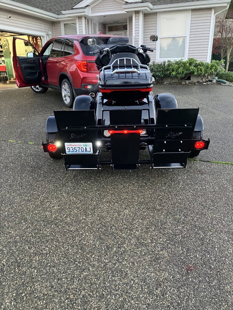

I have towed it down the freeway @67 MPH. I didn't know it was back there. Really a good match with the 2025 Honda Passport. A little concerned about the amount of wheel wash from the SUV that will hit the trike. Any good suggestions? I will post pics after ChristmasView attachment 130050View attachment 130051View attachment 130052
George,
Check out the Weather Tech Extended Length Mud Flaps in the link below. The video in particular..These look like a great option.
I will give it a close look. The dealer put on mud flaps just not sure they’re as long as the weather tech
I towed my 14 TG to Canada in my op 6x10 standard trailer last year behind my truck, we lucked out with the weather but still got a little bit of dirt on it. Not biggie, no worse than riding it really. Good mud flaps would alleviate this concern.
