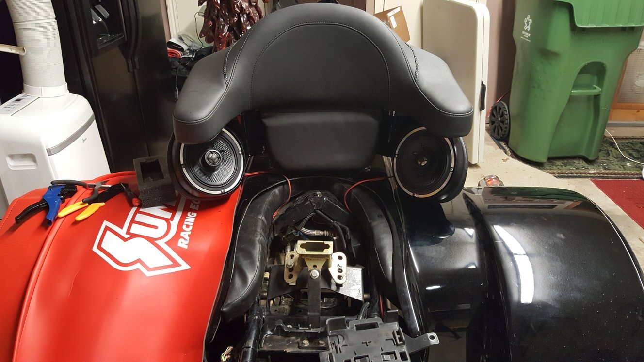

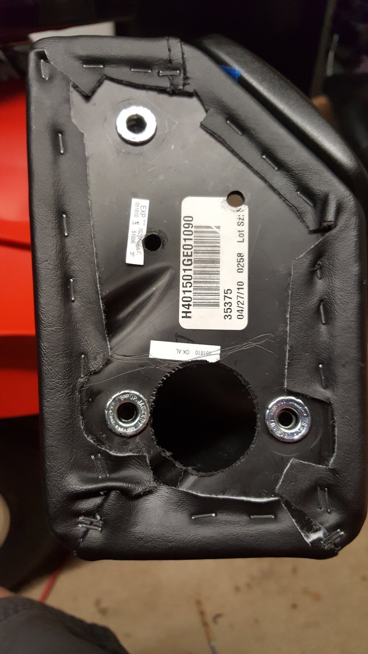

I have the Motor Guard delete kit on this trike and cannot put on lowers. I also have the HD chopped tour pak and cannot utilize regular tour pak speaker pods. I will be mounting my rear speakers a set of 6.5” speaker pods with a custom made mounting bracket. The location of the back speakers will probably mean that the back speaker sound will wash away above 70 MPH…but I should sound good in the parking lot…LOL

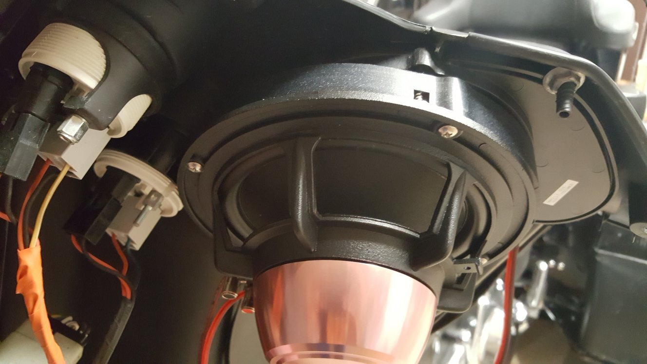

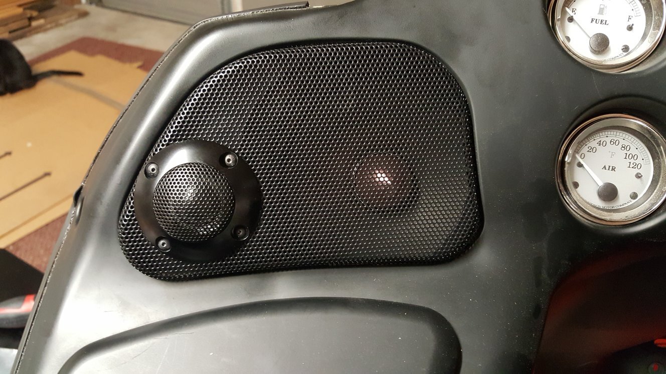

Speakers: Faring, HAT L6SE 7.1” Mid Bass, L1V2 20MM Tweeters and U2x 2 way passive crossovers
Rear Pods, Arc: Moto 602 V2 6.5” Coaxial

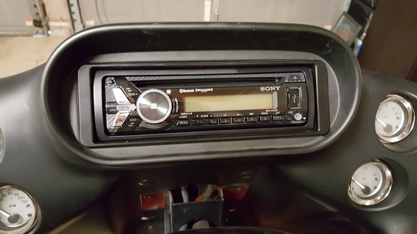

Head Unit: Sony MEX-M70BT with the Hawg Wired handlebar control module and install kit

New Sony Head unit mounted, the Hawg Wired Radio install kit and handlebar control interface sure makes it easy. Fit like a fine leather gloversz_20160709_133955.jpg
Got the tweeters mounted in the grills.
Gauge guards removed. speaker adapters and speakers mounted in the faring

I got everything installed and fired it up and started tuning her. I ended up cutting a hole in my rear speaker pods to allow the speaker to expand some
