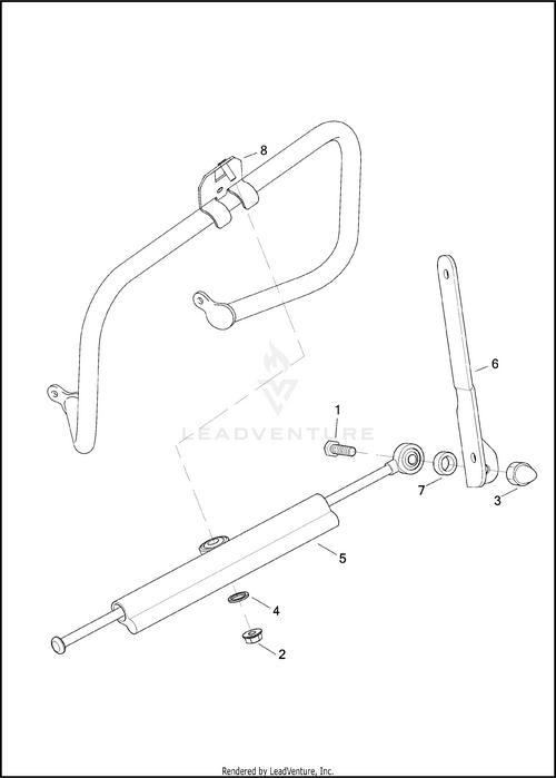

When I bought my 2013 tri glide the stabilizer was not installed on it. I can’t quite figure out how it goes on without rubbing on the lower part of the inner fairing. Perhaps I’m missing a bracket. I can’t find anything on YouTube. If someone has pics or can post a link to a parts diagram etc. I’d appreciate it.

I have a rake kit on my trike and I'm still running the steering stabilizer. The only thing that I did was adda 1 inch spacer where it connects to the bracket PC. 6.

Adding the steering stabilizer back after achieving the proper rake and trail our rake kit provides, is not recommended or needed, as it will only add additional effort to turn the trike. Close to zero customers that I have sold to have added the stabilizer back and not one of the several thousand trikes we have converted and TriGlides we have raked, have had a stabilizer added.
