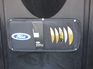

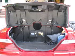

Nothing real fancy but it is my first modification, a visor CD holder from the Wally World sale bin, and a few tiny metal screws. Holds our MP3 Cd and the title and registration.
Mattel gets the credit as it is a slight change from his pouch mod.

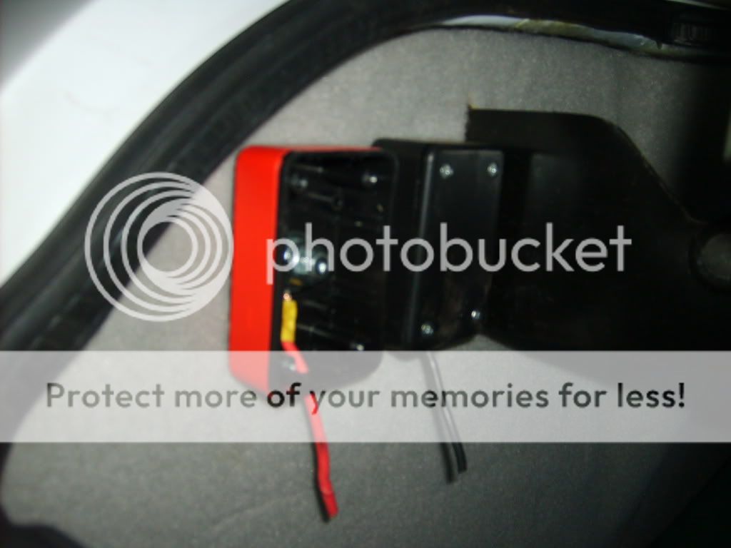

Good Morning all,
Well I finally put the trike on the ground.

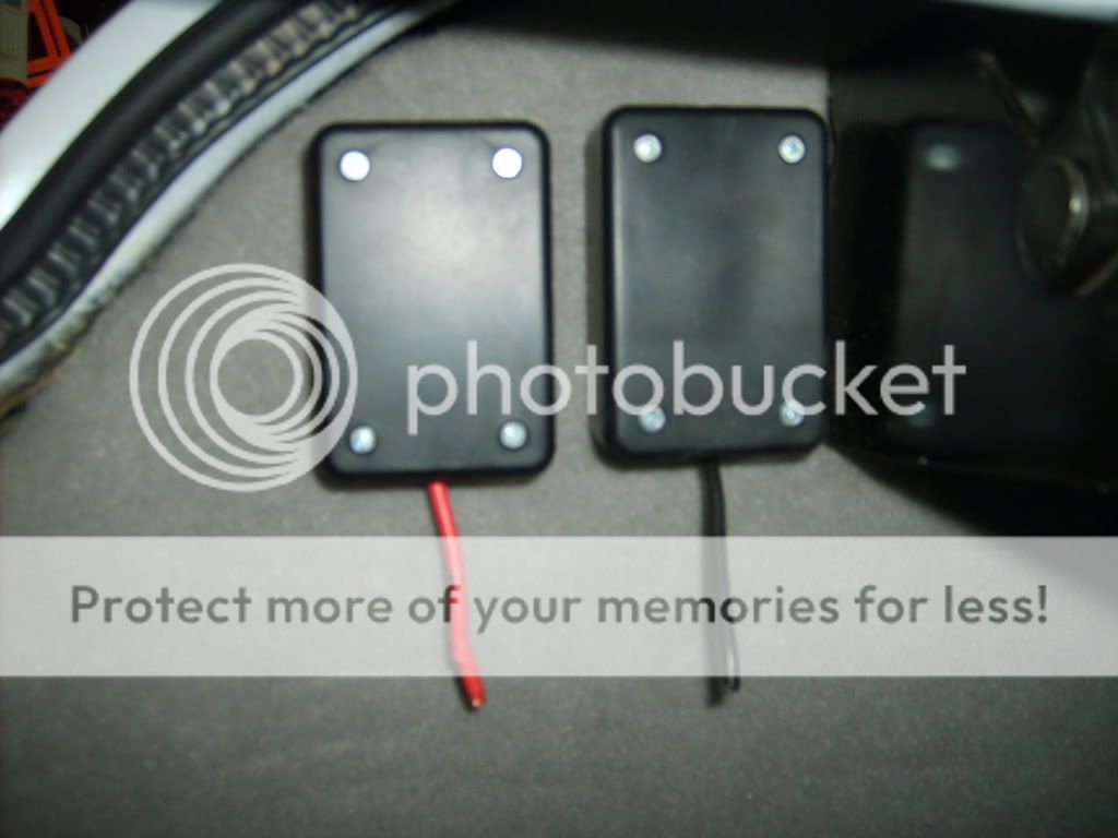

The jumper post are enclosed in plastic boxes from Radio Shack. The wires hanging down are for hard wiring a trickle charger. They are made using the battery side post.

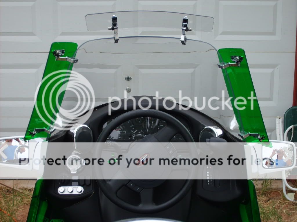

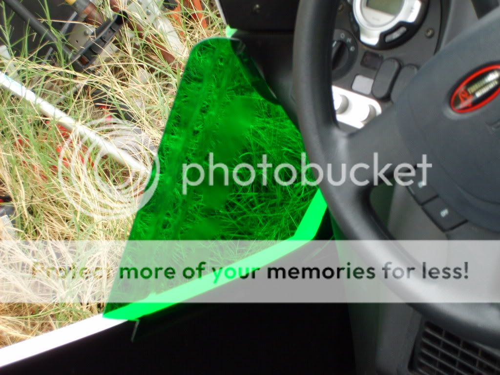

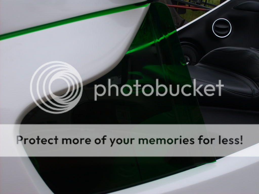

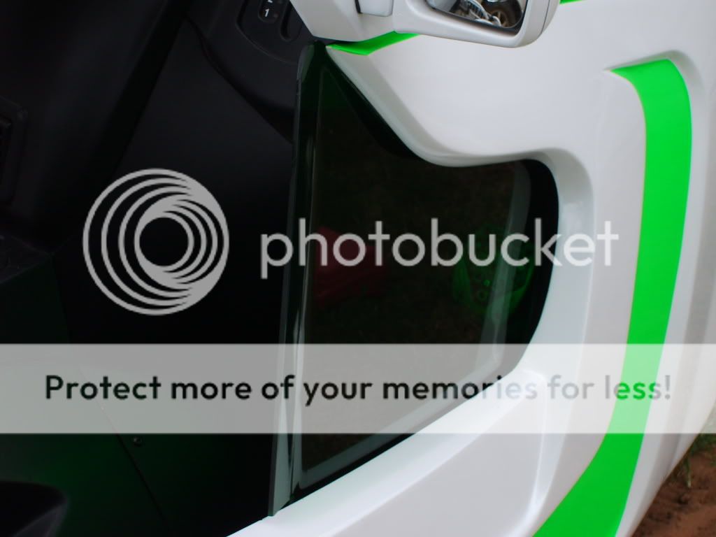

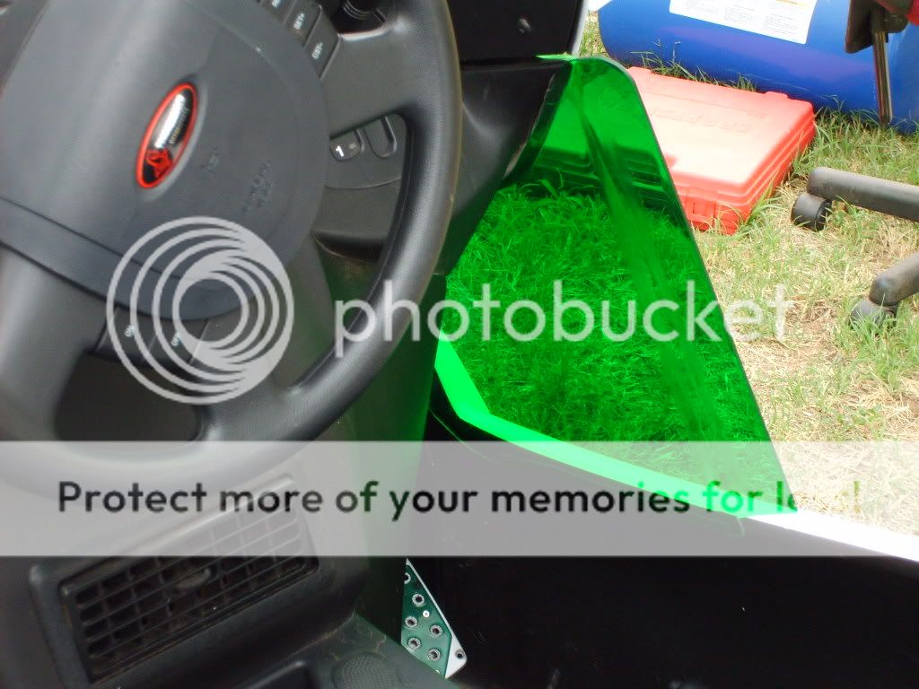

You will see the side wind deflector’s I made are attached with 3m double sided tape.
The top windshield deflector is an 18” Baker, I think it is too long so I may order the 12” or 15”.

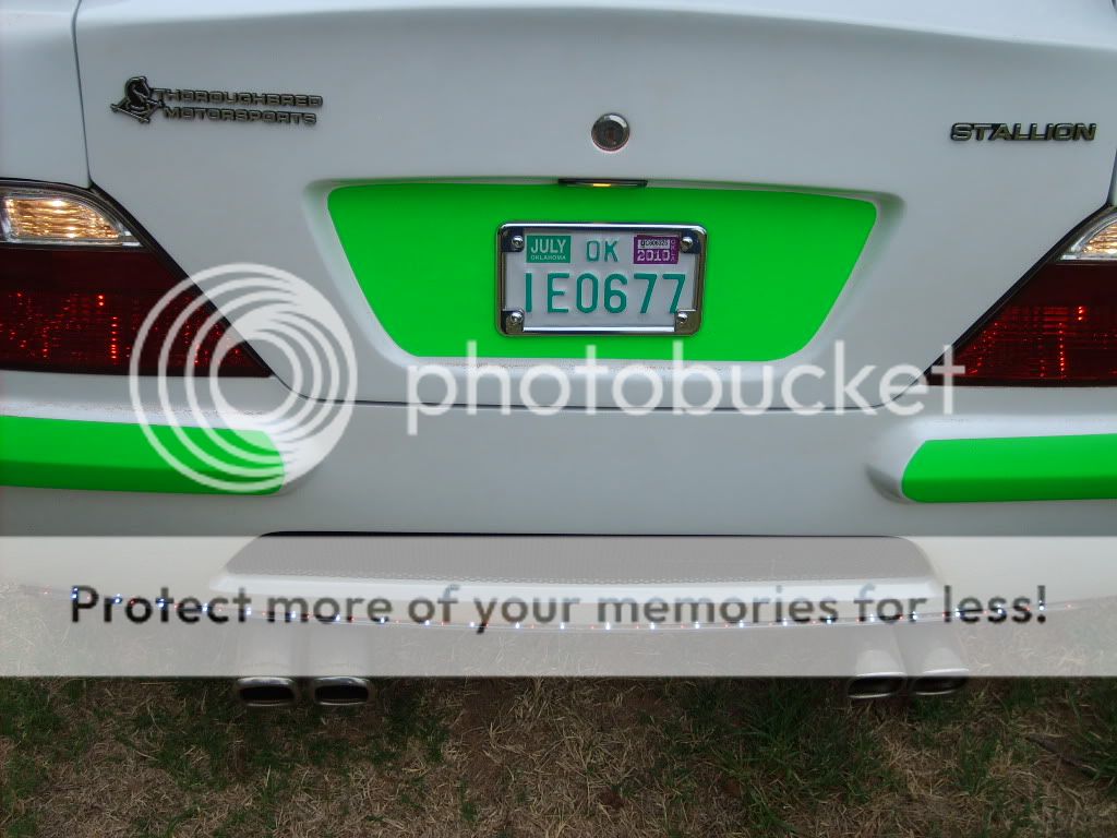

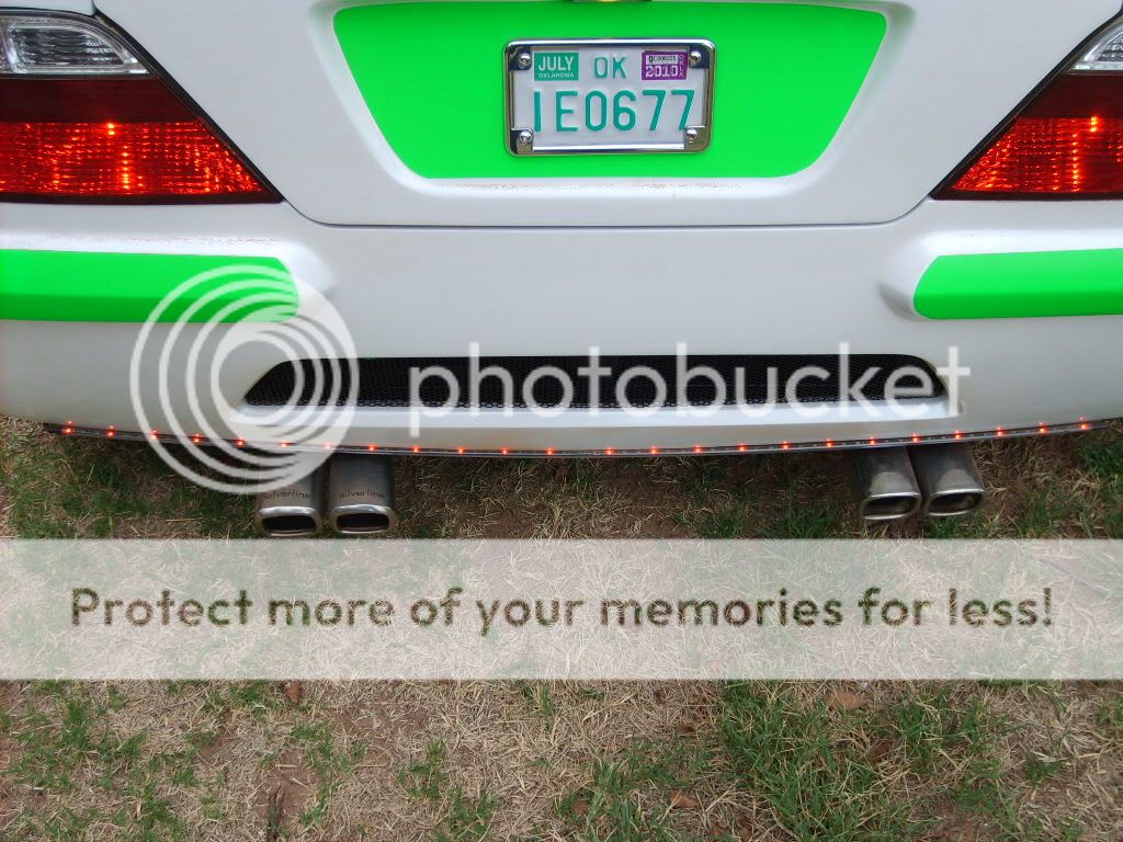

The Light bar in the back is a 48” Firestorm that I modified so I could mount it using 3m double sided tape. This is the second light bar the first one I damaged mounting and liked to never got it off. That 3m tape is some good stuff.
There is a set of yellow running lights when I am in a State that doesn’t like my green running lights. There is three light kits underneath on set is computer controlled and the inside is lit up with green led’s. The stallion looks awesome after dusk on but you still can see them just not as much in the daylight.
You can see the cruise pedals match my gas and brake pedals.
The seat foam was replaced by Bike Solutions and I don’t hit the seat pan anymore and the wife likes it too.
I didn’t replace the horn, that will be done another time.
Mounting the under lighting and routing the wires was very time consuming.

Billy I ordered the Green Plexiglas and made the deflectors on the body and the windshield. The clear top deflectors on the windshield is from baker wings. But I made the rest.

Very nice work.On your wing dams for the body,the picture looks like the dam is stepped and rests on the body or is the dam a flat piece affixed from the inside? THANKS for the pictures.
