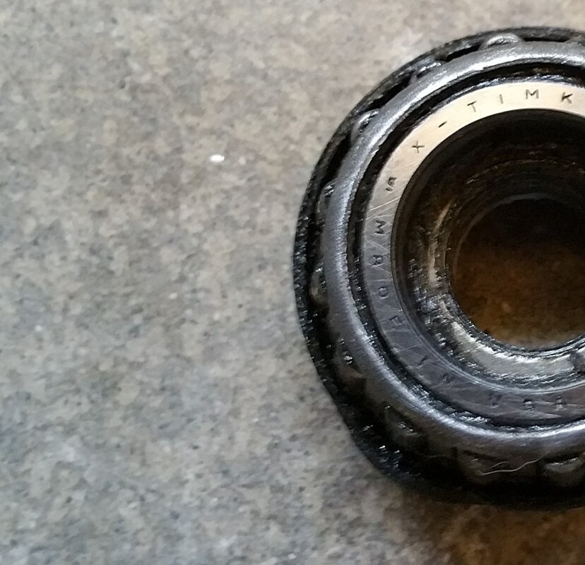

Lower bearing is worn and thrashed, the lower inner race is also worn with a lip/groove on the back edge, guess if I could look at the front edge it would have offsetting wear, or should have it.

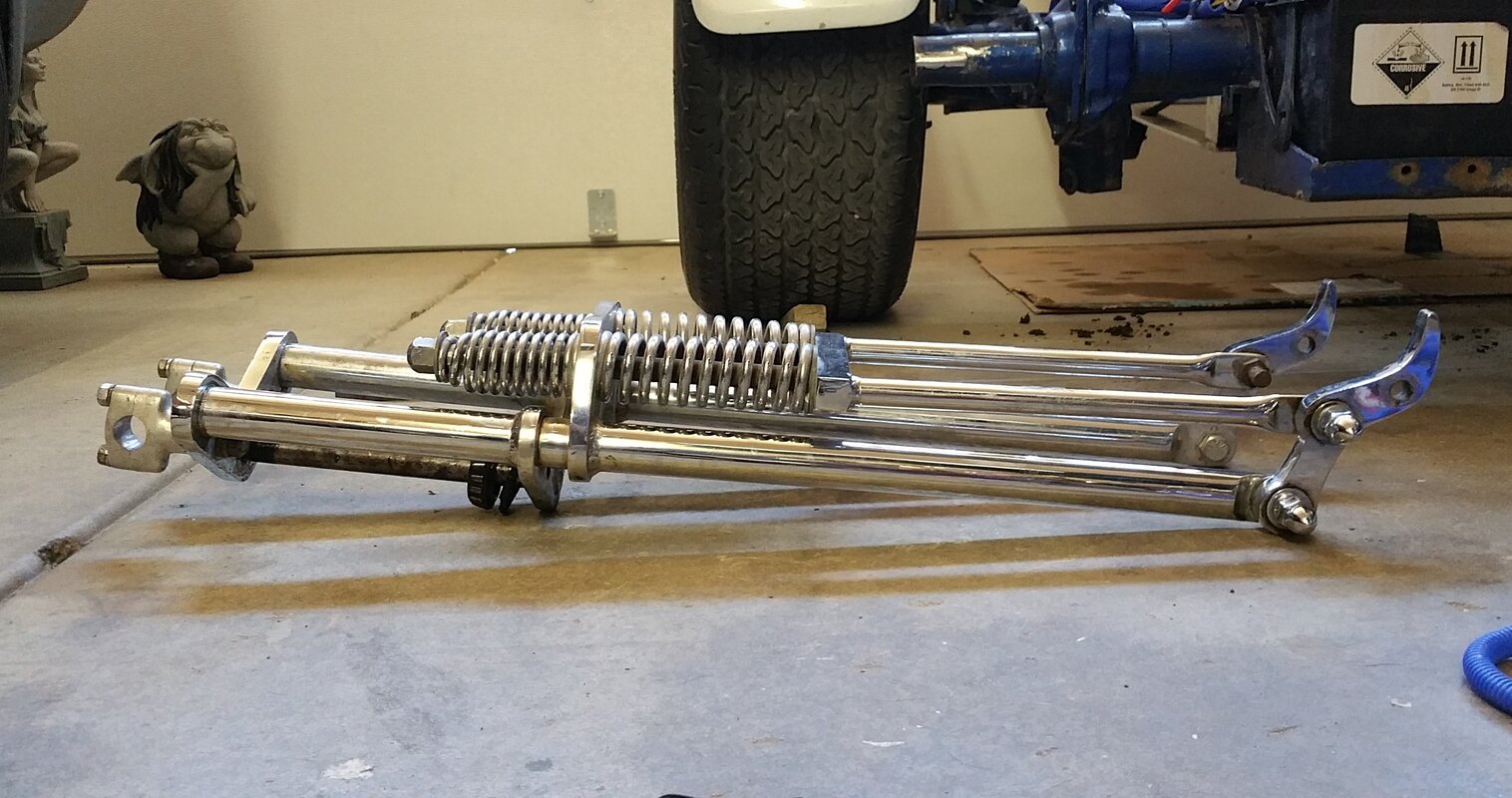

when the forks are laying in the above positon there is a rock from left to right, and the forks rest on the tips of the rockers and the tree holding the spring/forks. I understand that might not be a true level machined edge.
The tip pic above is with weight pushed down on the tree and it lifts up this tip, other side stays on the ground.
Next pic is with now weight on the tree and both tips set on the ground, look at the shadowing.
oops, the first tip pic is of both tips on the ground, than when weight is on the tree the left tip lifts up a little, 2nd pic.
tried to get a pic of lower bearing race wear, not so good.

In this resting position there are 3 points of contact, the center of the bottom tree and the end of the rocker arms and main tube connect. They do rest solid on the floor in this position, but kind a hard to get a rock out of the 3 point resting position. I am not a biker, getting to the triker, so have not seen springer forks this up front and personal ever, but there is a first time for everything, cross this off the bucket list, LOL
I would remove spring rods and springs, also the rockers, then check fork tubes for being like the letter H but racked, in other words the lower tree not square with the tubes........then check forks for twist or the letter H laying flat ,but with both top legs on a flat surface, then checking the rocker ends of the tubes for being parallel with the top tubes.

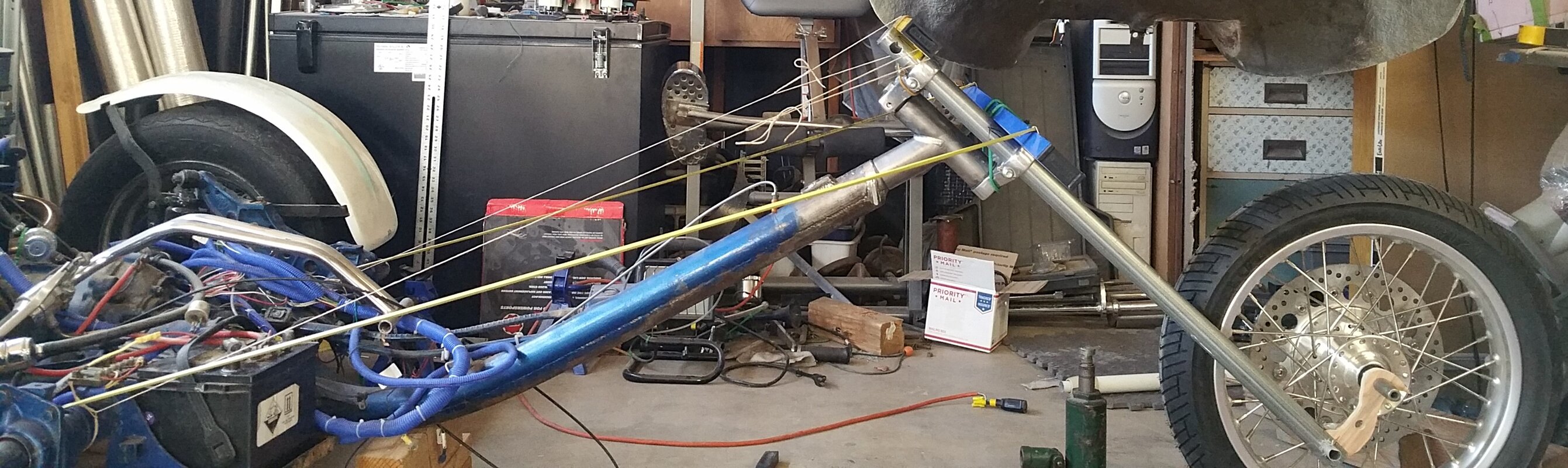

Okay I am bad, thought I had gotten all the fork pics up, did that, but the neck tube alignment got forgotten.
I took a piece of 1 1/4" fence pipe, never used as it was cut off waste, and slide it down inside the neck tube and tried to rest it centered in the tube.
I could not get back far enough to get top and bottom of pipe in the picture, I just have to much crap in the garage, problem is it is not all mine. I know the camera can make things look off when we take a picture, so I have tried to keep these things in mind when I take the pic, try to stay square and horizontal if possible.

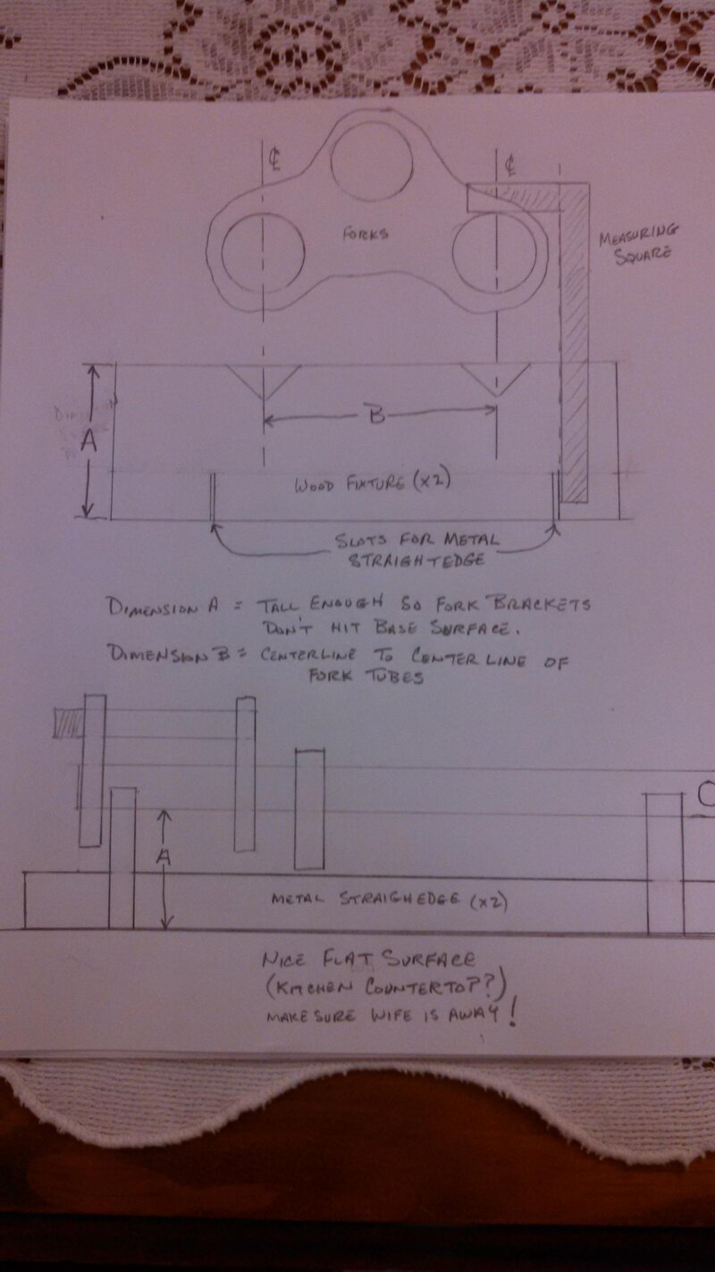

The fork pictures do look tweaked. Can't tell just where with out measurements. Here's an "Old School" CAD drawing of a fixture idea that I had that might help facilitate the measurements.
This fixture should give you a sufficiently straight and accurate measuring point to determine if the tubes are bent. By accurately building the 2 wood end brackets you will be able to support the disassembled rear fork tube assembly by 2 points on each tube and remove any errors added by the brackets touching any surface. The tubes should seat in the v notches on both ends and you should be able to take measurements at intervals along the tubes from end to end. I thought that an L square run along the top edge of the tube would allow you to make measurements easier. If you set the spacing for the slots in the wood fixture so the L square is vertical from the edge of the tube you will be able to measure easier. Just make sure that the horizontal leg only rests on one fork tube at a time.
I'll bet you will find that the tubes are bowed around the bottom triple tree bracket. You might be able to straighten the legs with a press and some suitable leg supports. Do the pressing cold and slowly (measure, press, measure, press, etc. High point center will move some.) will probably preserve the chrome too. If you have a local machine shop, check with them about shaft straightening. I have cold press straightened shafts to within .001" with just a hand arbor press and some v-blocks.
Check the front legs this way also. Also measure the flatness of the brackets by laying a straight edge across them. They should be flat.
Once you know the forks are straight, install new neck bearings and races and see what your tire alignment measures look like.
Hope this helps. Good Luck!

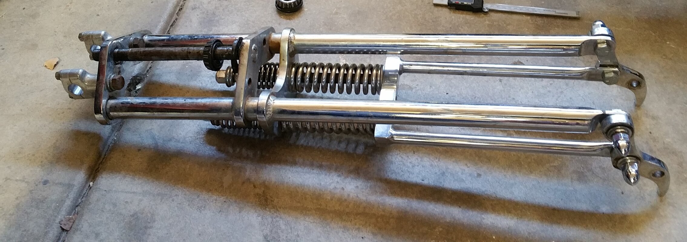

VWbug, that was a lot of help to see how bad things are.
Once I got all apart and checked things the spring rods are bent and the spring tube legs are bent, plus the springs were not sized up correctly, or have just worn differently over the years, or the bent up front end was long ago and usage did the off wear on the springs......... just trash to me now....

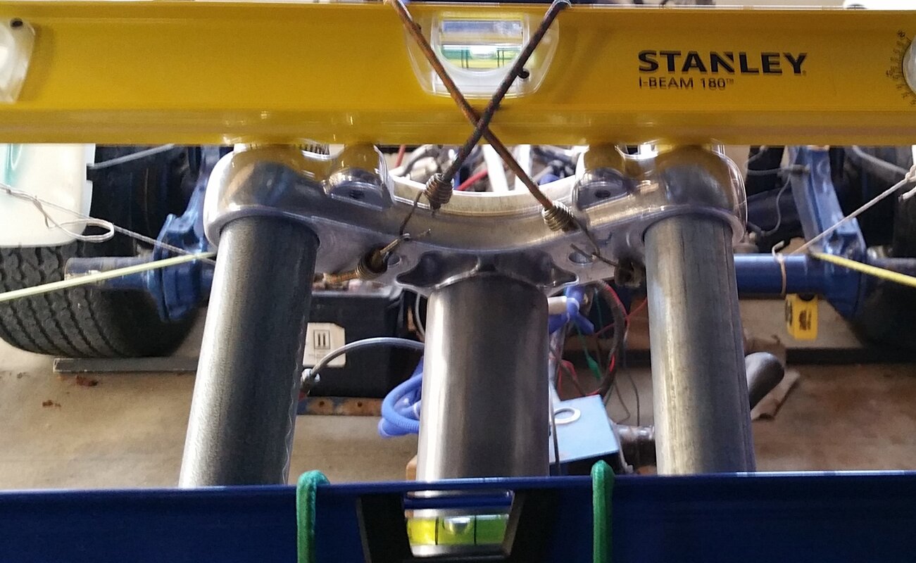

This is were I am at. Triple trees all mounted and leveled. It took some playing of back and fourth, but after some time I got it all to line up and give me the same distance reading on the tape measure's. Top shorter yellow level allowed me to make sure the top tree was set the same as the lower tree.
I think this was the best pic of the levels and their bubbles, I still did not get directly head on with the camera, but close.
Looking good so far!

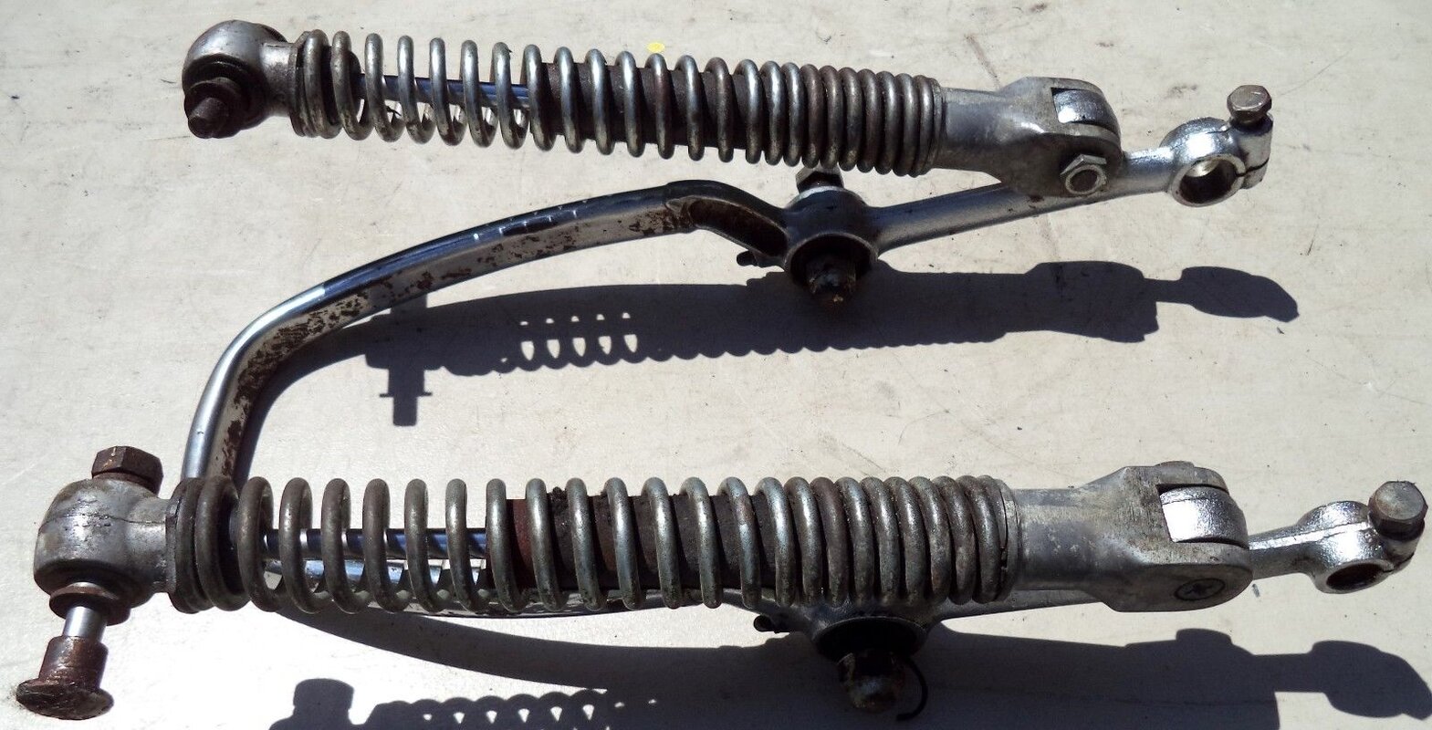

My first bike was a 65 Honda Dream (CA77) and it had an Earles or springer fork assembly. The springs weren't that big as shown below. They had a small diameter shock/spring and held up a 350 lb motorcycle and 250 lbs of rider/passenger weight.
I'd suggest that you fab up a portable jig to measure spring rates, determine the old spring rates, and then hit up the local MC salvage yard(s) to find a suitable shock assembly. The rear shock/springs of of some of these Chinese scooters or a small ATV/Dirt bikes might just fit your application. Your front end isn't that heavy due to the rearward weight bias of the design and the rear fork tubes are handling the major stresses. The shocks (especially when short) aren't affected by these major stress loads. It's when you add an extended lever arm to the springs/shocks as in a springer (or monoshock) fork that you have bending issues.
I had measured the compression of the old springs, was even thinking of using them again until my read yesterday.The old springer set was off, one of the lower springs were shorter than the other, and now you have the upper springs with different compression distance for same weight. Trash from what I read, good in a pinch, but not ideal for a new set of forks..The lower spring are 200 lbs per inch and the upper, and one is shorter by 3/16" from the other and up top the springs are equal length, but compression rate is a little stronger on one over the other.......orginaly they were 50lbs per inch.Lower spring is where the preload is set ??? The top springs are under tension also, but it is not much and it is there for the pre load rebound?
Bitter End Old school Choppers has spring sets for sale and also sells the mono shock with spring, but nothing listed about compression ratings....... It will get figured out, I hope I do soon.
