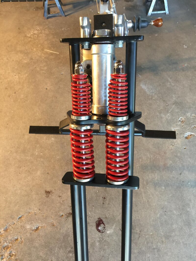

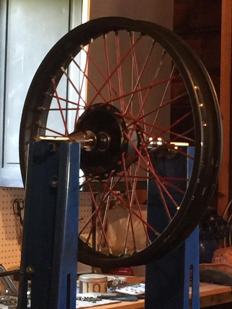

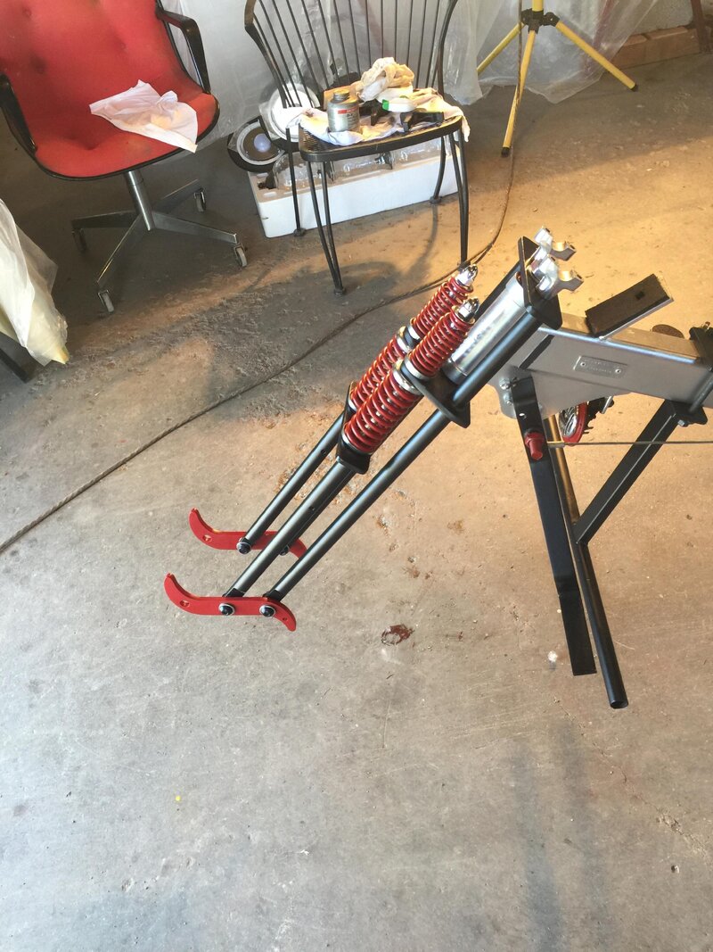

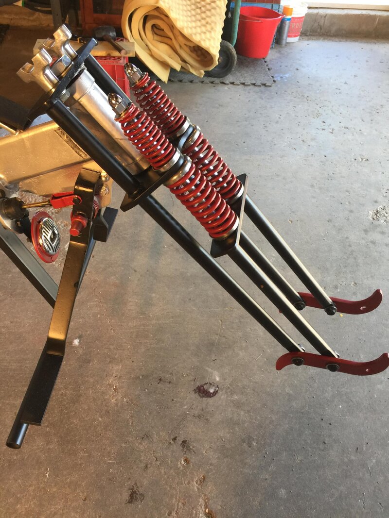

Thanks for the info. Got it back together everything went smooth. LOL. Here is a Couple of Photos of the front and the rim. Rim needs a bit more TLC. Got to disassemble it again. Messed up and gave it few scratches. So it is good training on how to lace and true a painted wheel and spokes. Had got it to a 1 mil (+/-) runout both ways.
Sorry for the sideways photos. They turned when I uploaded. Got to figure out how to correct that. LOL.
At first glance I though china ebay.
But after looking more closely it is not. Even though it is simply made it is also well made. For instance the rocker pivots are machined billets.....not just a squished tube with a hole drilled in it.
The springs are mounted lower than a fork for for a 2 wheeler would be and the rockers are longer also.
So I am gonna say it is a custom built specifically for a trike. Quite possibly by one of the long defunct custom builder outfits.
The probability of being able to purchase one, while not zero.....is approaching zero.
The chances of finding a custom trike shop to build one is slim, but possible.
The chances are much higher of you building one yourself to fit your needs.
Maybe someone knows where to purchase something similar. But as a trike needs considerable less trail and a more robust design......and all tailered to a non production frames geometry it is unlikely any production unit is going to be correct.
