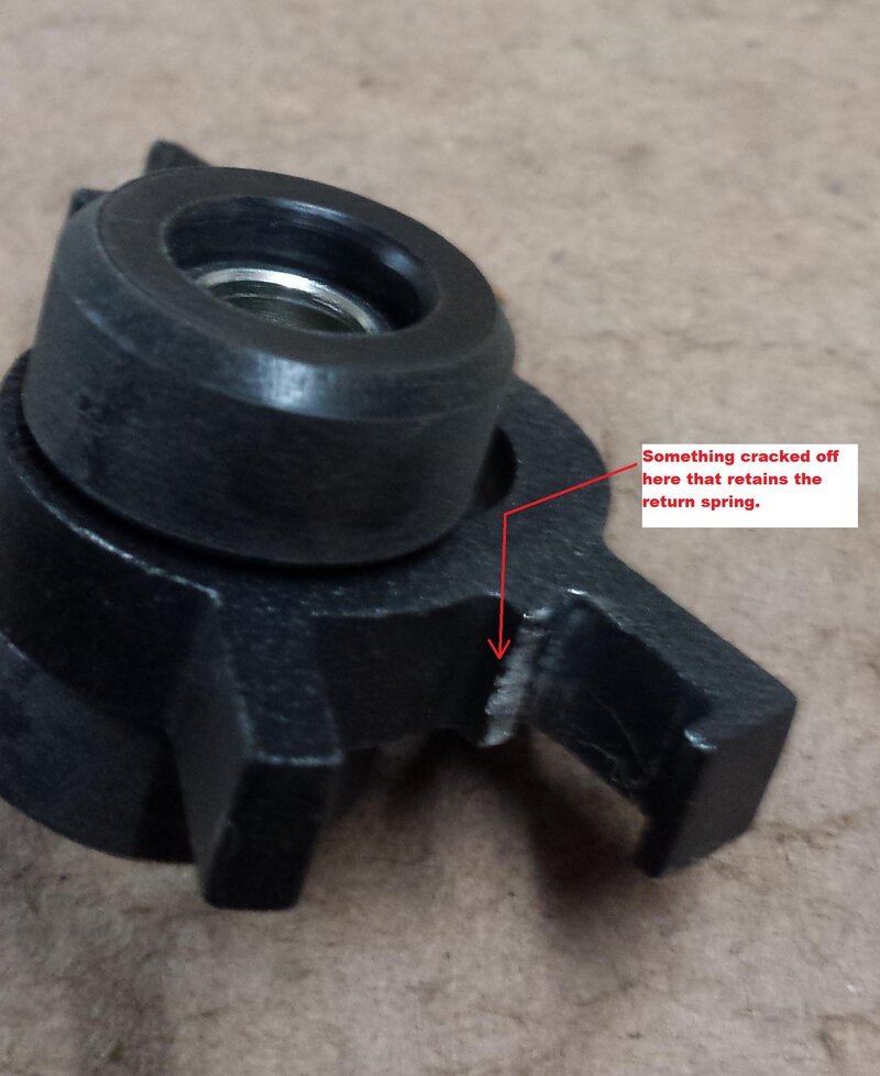

I have the moto-trike mechanial reverse ......And if left in reverse on a hill it will roll... I don't use my park brake at all i just leave it in first gear... And it won't roll on a hill...:Shrug:
It is a very simple system until the pawl brakes. :AGGHH: My 2014 TriGlide was changed out under warranty.
I'd bet yours is broken.

HDBOB, the pic you posted is not familiar. I wonder if the parking brake on the Tri and Freewheeler are the same.
I'll have to look at it again when I get home.
Same parking brake Rushmore TriGlides and FLRTs .... this is the ratchet pawl pictured with both side bushings on it. The ratchet spring clips into it ... and the spring is over the pawl on the same bolt going through the center of the pawl and bushings. Pawl is P/N 83000018.
