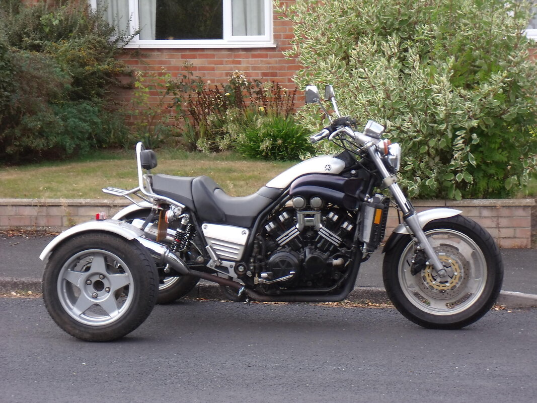

Hi, British newb here & newb to trikes. 1st post & need some advice.
My (yet to be ridden) trike is a Yammy Vmax 1200 (1998) with home built soft tail swing arm & english rear axel (ford escort mk1), compomotive 15" rim wheels. Bike section is stock Vmax as far as I can tell.
It had problems with the rear home built swing arm & shock absorbers when I bought it. I've done a lot to sort that out.
It had the original 1998 stock rear shocks on & they were spent & I've replaced them with some YSS eco lines but the springs seem a little soft. I have yet to ride this - still putting it back together.
I have checked the YSS spec's & their Vmax replacement coil over shocks progressive spring rating is 25-35 N/mm & mine have 20-30s. I know I should have checked 1st but that's hindsight (& ADHD).
My question is, in general, should I be going for the same spring rating as the original donor bike or something a bit beefier?

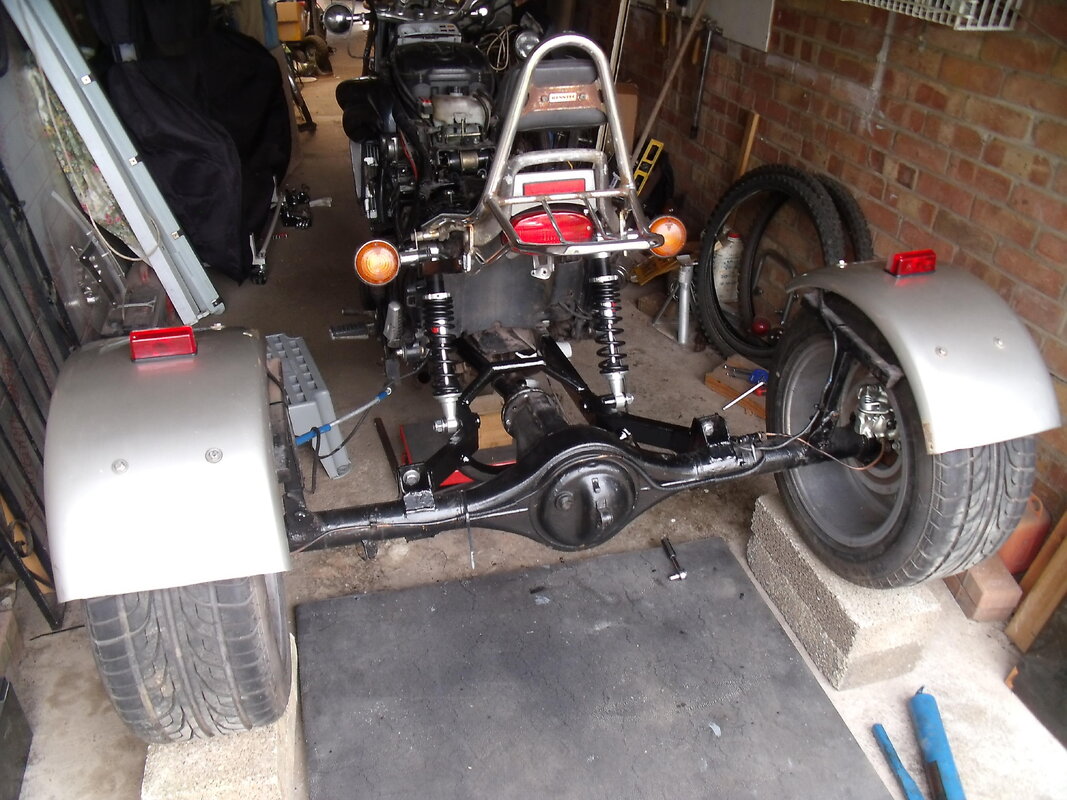

Previous set up (shocks removed).
New.

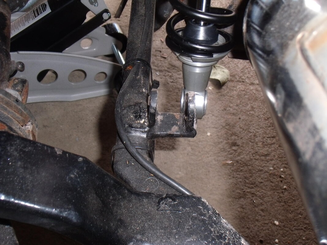

Update:
I've managed to get 20ish miles riding in OK then another 40ish not OK (fuel pump + carb issues). To get anything like a decent ride I'm on 42psi in the front tyre (max stated on the tyre) 21psi rears & nearly all the adjustment taken up on the rr springs. There's maybe 20mm left. I don't know if I can get anything nicer, ride wise, with this set up (as I've never ridden a trike before) but it feels OK & stable. This will do for now I think but I will get the next rating up (25-35) sometime in not too distant future.

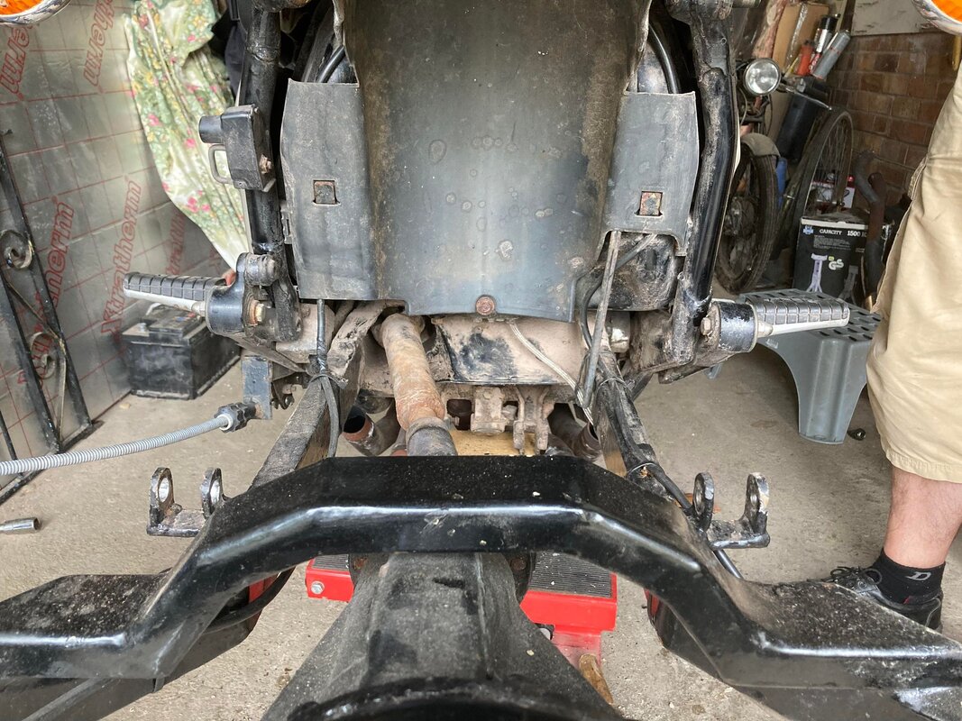

As an aside I found picture of how far out the original rt rear shock mounting point was when I bought it. This pic has the new YSS shock mounted to the frame & lightly tightened. It's 1" out.
