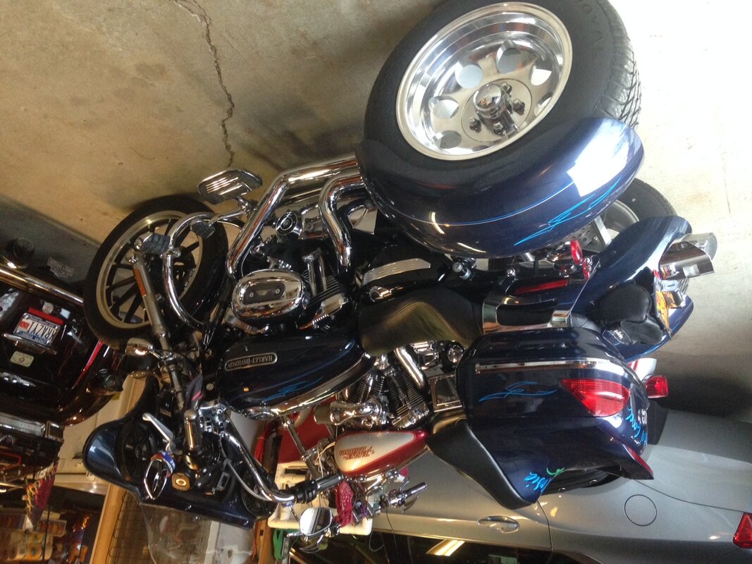

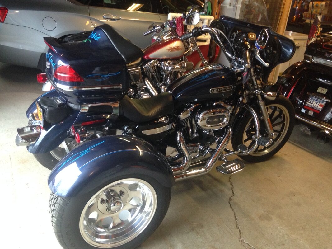

trike.JPGtrike.JPGWe installed a Frankenstein kit on my wife's 2009 1200 low. She loves it. We had a small touring pak installed on the back attached to a quick connect system so she can take it off if she wishes to. The front forks were racked out 4degrees to help it steer easier. We installed 10 inch mini apes to help it steer easier and more relaxing for her arms to drive. It has Vance Hines short shots on it and she loves the sound of the exhaust. The kit was painted to match the rest of the bike. I also installed a fairing with a stereo system built into it.We like this kit because we didn't like the looks of the wider kits that were available. Thanks, Krazy "I"
