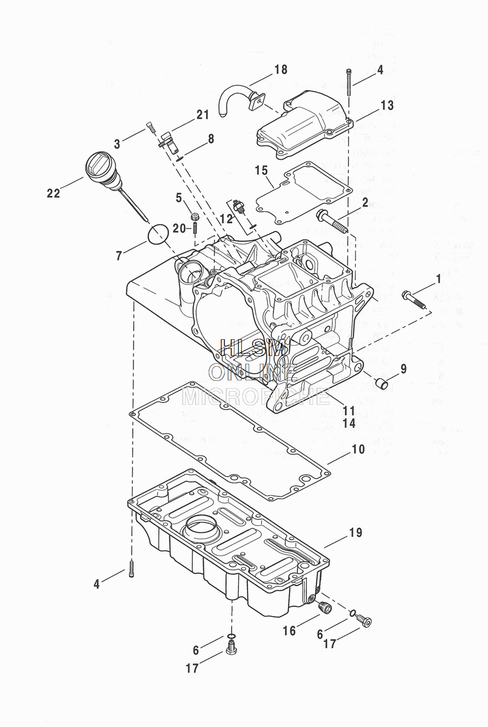

Ok my buddies 2013 Tri Glide speedo as stopped working,the odometer still works and and the 6 gear indicator doesnt work so were is the speed sensor locatated.I see the neutral switch but nothing that looks like the speed sensor.It is throwing a P0501 code VSS Sensor low.Any help would be appreciated and no he doesnt have a manual and im not buying it for him LOL Thanks

Steve, the #1 cause of the sensor not working correctly is a build up of metallic filings on the magnet. If it has healed itself for now expect it to act up again. I had this problem on 2 Dynas, never on my baggers or trikes. IMO the type of gear lube used and periodic changes can make a difference. Good Luck and post up your findings;)

Steve, in the old days we would fill the case with kerosene, start the bike and run it thru the gears, Then dump the kerosene and refill the lube. WE also used Kerosene to flush the oil tanks. This worked pretty darn good:clapping:
I had to do a repair on a drain plug on the oil pan and i had to make a special over sized bolt to open the threads up some and i used kerosene to flush it out,didnt even think of using it to clean the speed sensor thanks for reminding me.
