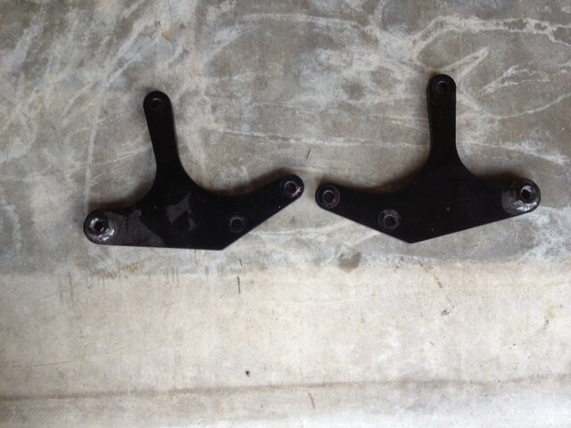

The only positive points we found for the lift kits were it kept you from scrapping your mufflers and made it easier to load into a trailer. Ours came off after 3000 miles and resides in a box of other misc. stuff. That was one TG back in 2012.

I appreciate the responses.. Note no front end changes, I put Kevin's kit (recommended by the dealer) on about three weeks after getting the TG a year ago. We've only got about 6K on it, with the two up riding being fairly mild as far as speed, probably 60 or 65 Mph tops. The tuning runs where I first really noticed the twitchy or less stable feel are on a wide, flat 20 mile stretch of Florida backroad blacktop (won't say where, but No houses on most of the road) that's perfect for the various combinations of Rpm/Speed that are necessary to duplicate dyno conditions (looking out for hogs, of course).
This is the same trike that had the entire rear suspension off while diagnosing what turned out to be a defective drive pulley (wobbled). They went to a lot of trouble to verify alignment at the time, I put the lift on after that and went over all fasteners at that time. I get a chance though, I'll talk to them..

Both operations shorten the trail in the front suspension. But 1.6"lift is too much rear lift. Most kits are 1.25".

If I am not mistaken the DK comfort lift raises the trike 1.25 inches at the shocks and 1.6 inches at the back of the bike??

A couple of notes, I DO have the 1.25 kit, was quoting the body lift as stated in the literature.. Also, just occurred to check the tire pressure gauge I'm using also, shouldn't be that far off, but........
