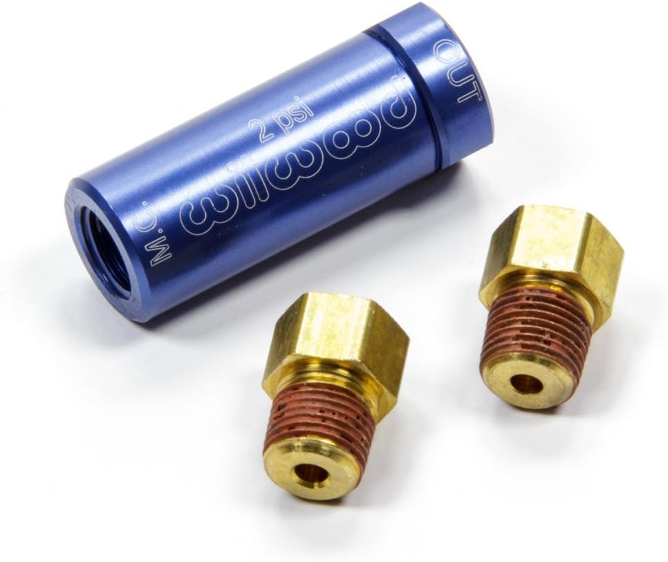

First off, you need to make sure your master cylinder is ok and not leaking internally.
Second, install a residual check valve somewhere on the line feeding the rear brakes and bleed the rear brakes to remove all air
If you can have a helper pump the brakes ( slowly and do not use full strokes, that could damage the seal in the master cylinder).
Start bleeding with the caliper furthest away from the master cylinder, once you are sure no more air is coming out of that caliper repeat on the other caliper. ( Do not run the master cylinder empty during bleeding.
This should clear up your rear brake issue provided you master and calipers are in good working order
This valve should work for you, mount it close to the master cylinder ( facing the valve in the correct direction )
Here is a link to Amazon for purchase
