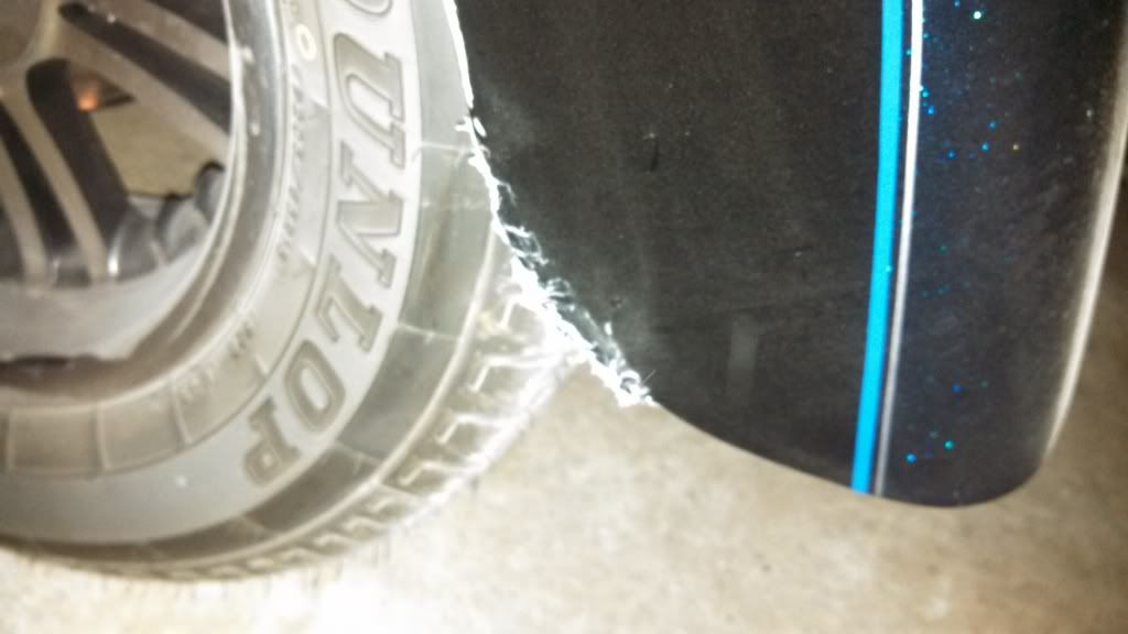

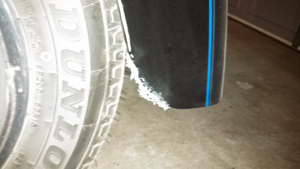

My oldest son is home for the weekend with his new bride and baby. Asked to take the TG out for a ride with his wife. I was like "sure np", he is an experienced rider and felt he could handle it. I just said make sure you watch your ass end cause of the 2 wheels....
Welp, he comes back home and tells me he hit a hitch on a truck. He and his wife are ok. Just have this little bit of damage to the right rear fender. Do the fenders on these TG's come off or am I looking at something much larger to repair?
Hopefully these pics show what I mean....

There are a couple of used fenders on e-bay last week. Take a look maybe one like yours. They come off real easy. Bolts are in the trunk and infront of the trunk.
Like the first suggestion...after taping the area with masking tape (to prevent paint splintering), carefully grind, then file, and sand a contour on the edge of the two fenders...You'll never know it.....ThumbUp
hard to tell but looks like curb rash?? check ebay they sell fenders all the time or smooth out yourself and paint.
good luck
According to him....
He clipped a trailer hitch on a pickup truck that was parked. To me..I agree it looks like hit a curb or something hard and abrasive..but I will take him at his word.
Unfortunately there are no fenders on ebay with Big Blue Pearl/Vivid Black. Don't want to go the paint route unless necessary.
