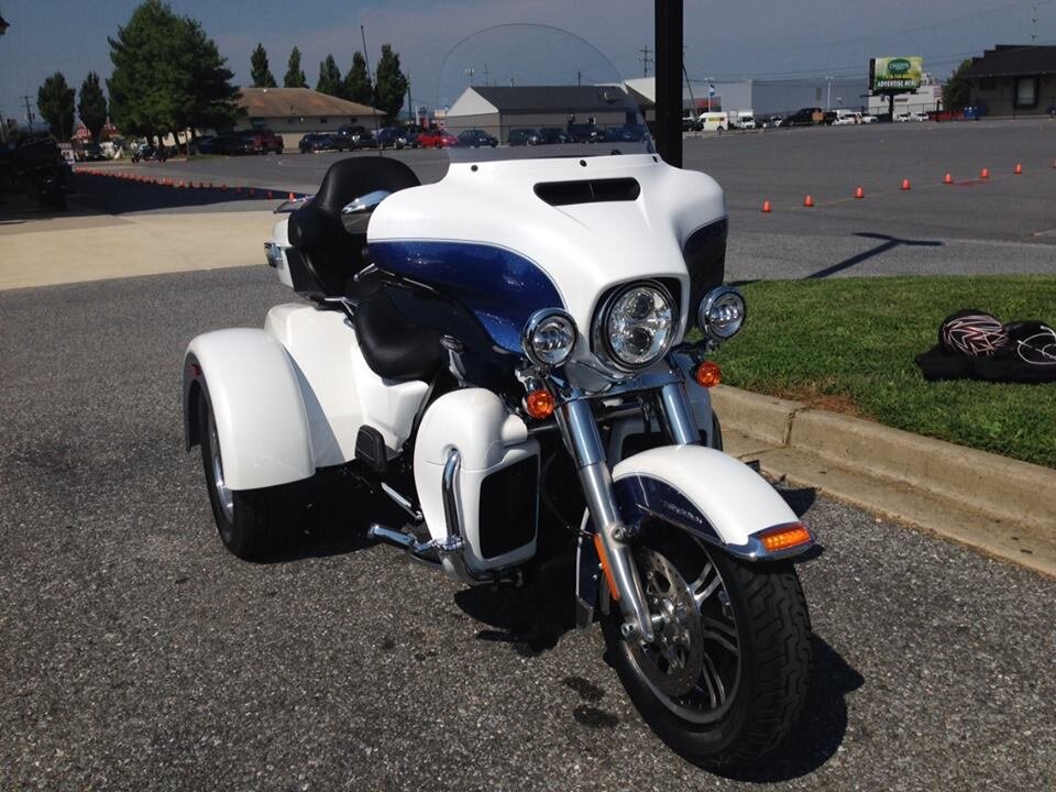

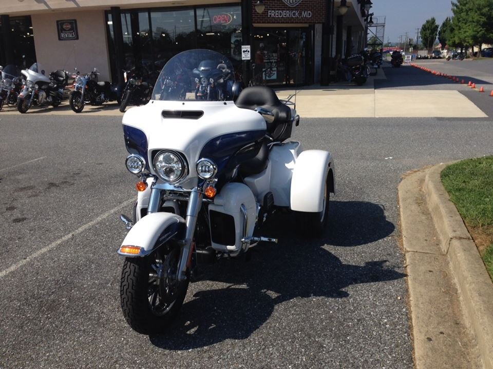

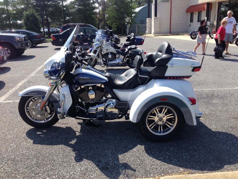

Well, picked up the new scoot this last Saturday! Lovin' it! :D
Vince.
