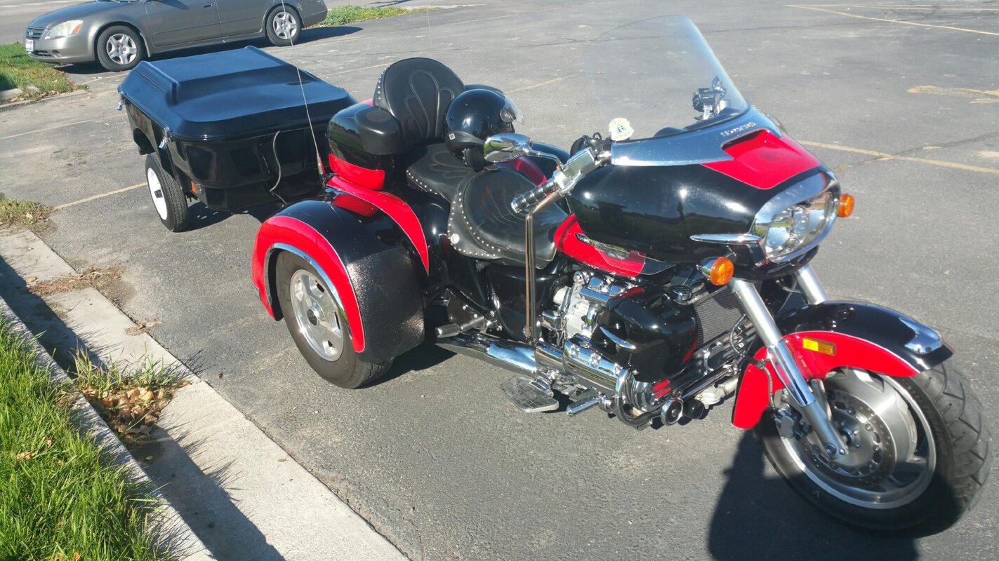

This is a pic of my trike.
Nice looking ride!!!
