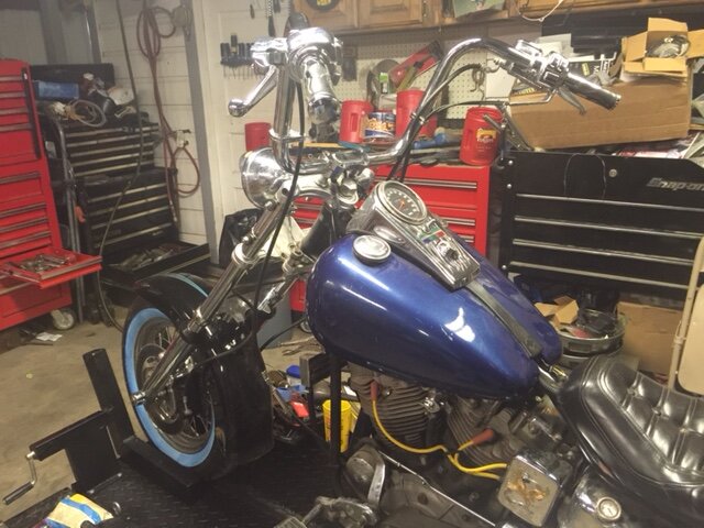

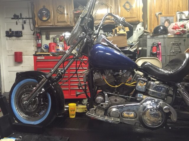

Have shaky bike, it has a fork brace, and a new trike tire zero miles balanced of course, rear end measures straight. 15 pounds air in rear tires Ive run for 35years at 12lbs now 15lbs.
Tightened fork stem till it quit and backed off a notch. Originally in a stock frame, it was tweaked, i changed it out for a supposedly stock reman, its 2inch tall in the front legs and the rear seat is dropped.
Front end is a Kenny p, raked tree adjustable, with 10in over forks, when i had the Harley raked trees 6 over but needing 8 or i never had this prob.
Before i go back to a 10 over with Harley trees Im going to put a adjustable steering dampener on it. If that don't fix it, Im outta options.
Im into suggestions from the elect, that means you. IMG_1174.JPGIMG_1171.JPG
You should measure the trail on that setup. Hard 2 tell from the picture but it almost looks 0 or negative.

wonder what the trail is... with extended tubes the trail is bigger because it lifts the front of the frame..
i am betting you still have too much trail... i find around and inch an a half work for me.. some dont like it that short but works for me

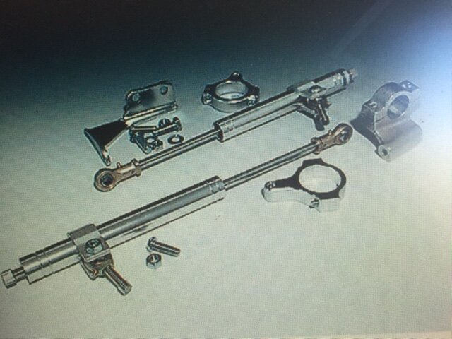

ABOUT $170 OFF EVIL BAY. COMMENTS ANYONE. ???IMG_1182.JPG THEY BE IN THE MAIL I DO BELIEVE.

Heres a band aid that might work for the slow head shake that Ive never experienced before, Grrrrrrrr, why now. ? :mad:
ABOUT $170 OFF EVIL BAY. COMMENTS ANYONE. ???View attachment 33312 THEY BE IN THE MAIL I DO BELIEVE.
imho it "IS" just a band aid..
i personally i would opt for trying to fix the problem

have you tried to figure how much trail you have??
raked trees
Try measuring the trail. Photos look lake too much negative...

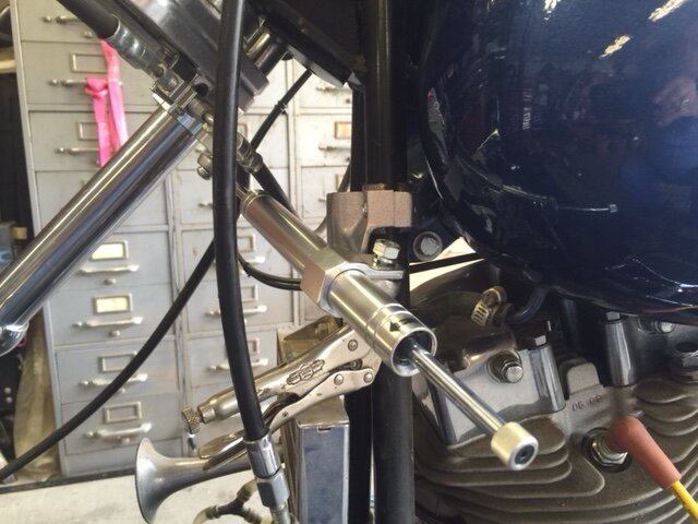

OK girls here we go, if the pics download. Installing the stabilizer, of course i didn't think it was a bolt on, and its not. Since the bracket is bigger than the frame tube. Ugh.
To be expected, but my lead tech being a smart feller, took half my idea, i saw a set of Harley handlebars up, with the knurling, cut out of the bars and split, then wrapped around the tube, better yet lead tech breaks a hack saw blade piece off to put next to the tube, then the shim made outta the knurled handled bar to keep the bracket from slipping, hacksaw blade keeps the shim from slipping, damn smart on his part i would have never thought of it.
Almost installed. Progress report coming.

Im pretty much unimpressed with the shock setup, its a Daytona, sold by many for more than i paid. Ad shows a two set up which is what i thought i was to get.
Seller sent one, Ive notified them im short, the ad no say take you pick, it shows 2 and says one like a kit ? So emailed them, waiting for them to tell me im stupid.
Ill let eBay takem on. The shock itself has little if any resistance. If its nitro filled, its gone, at least to me, if its hydraulic its never been filled.
Beware if ya buy this kit or one like it, seems substandard to me. Kit i paid $159 for others Ive seen almost twice the price and its same same.
Never had this problem with a extended Harley front end of 6inchs on a stock frame, with Harley raked trees, others Ive built using a narrow glide with a permanent 10degree rake tree handled like a cat on a hot stove.

If your looking for a shock set up similar to this, don't buy this one. MO. Its sold under many names on eBay, but you can tell by looking its same same. Save you money and buy or build something else, altho i like the brackets on this one.
So far i cant upgrade to a ohlin shock that Ive seen as they are 8 ball shaped. Hundreds of shocks on eBay, all from Thailand, china. and Timbuktu.
Suggestions ? overall about 15inches long, 1 inch od. about a 5inch stroke, and no almost 100 percent of the sellers don't list the details.

I thought about duals, an when i ordered the kit the pic made it look like duals, yeah yeah, we know better, but who could a guessed. ? read my previous post on it.
Guy straightening my Dyna frame says he uses vw steering stabilizers off a bug, only cost 20 or so, been a while since he bought one, 69 bucks on eBay.
makes his own brackets and hes happy with the results, i may go that direction on the street glide, but prefer a more professional look, that may change.
I need function over form sometimes. :cool:
I was wrong he was wrong, vw stabilizer was 27.50 on eBay, mechanic that tole me 20 bucks on stabilizer was closer than my 69 bucks i had found earlier in the week.
Not a stabilizer locally yet. Would jus like to put my hands on one an test it before plunking cash and shipping an all that rot.

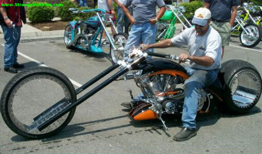

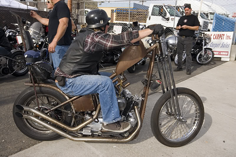

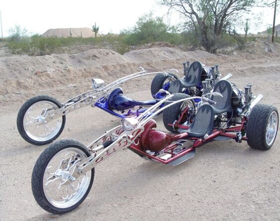

Very few people understand rake and trail. A friend of mine built his own front end,showed it 2 me. I mentioned that it didn't have much trail. I said when the the trail gets much less than 2" they felt 2 twitchy 4 me. Well as he said later he had no idea what trail was,so he lengthened the swing arm on the leading link front end. That put him at about 2" negative. Went down the street hit about 25 mph,went into what he called the wobble from hell,tore the bars out of his hands darted to the right,flipped the rig on top of him. Now he's sliding down the street with a sidecar rig on top of him. Ground thru his boots right down 2 the ankle bone. So yea its important. we only make suggestions on these threads because we want 2 help.
Proper Rake & Trail configuration is complicated and can sometime defy logic.
Examples:
In theory, these should all be unrideable at high speeds or through curves, but they are not.

I think its a combination of factors, one being the new frame with 2in stretched tubes which is was not suppose to be, and the dropped seat rail, it was suppose to be a direct copy of the Harley frame, not so, and im unhappy, but it sat 14yrs and now its a little late to do anything except cry about it or adapt to it.
I can see the end game coming, Ugh, pull the front end, buy another lower tree for the 41mm tubes and bore them out to fit, then cut down my tubes and rethread, dropping the front and leveling the frame, an go from there, im dreading it.
Ive been over a year bringing it back to life, and wanted my girl to ride this summer a bit, if i bring the front end in too much it raises the bike and looks a bit odd, and or does it affect how it handles adversely by being raised in the front. ??
I had the brace higher on the forks and lower it to see a difference, no difference that i could tell, that step one.
Step two i installed a stabilizer, and as poor a product as it is it did take some, some of the slo tire shake out.
Step three will be to pull the rake in a bit, which is a bitch, it looks easy, but it aint. Why ?? darned if i know, took a 4 ft pry bar to line up last time, two adjustable holes at the top.
