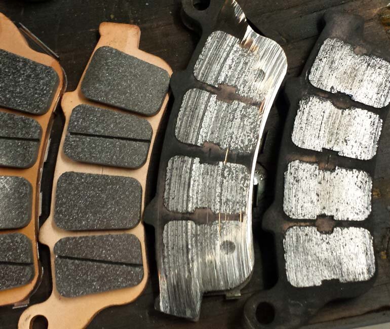

OK, I wanted to up-date this thread. To all members that contributed to this thread, thanks!! :clapping: There were also PMs that had very good technical information. Special thanks to Solidbob, scribe5 and lgjhn who gave detailed instructions and help. A couple days ago, I put on front pads. One of the pads (out of 4 on a side) was more than 50% down to pure metal. (See below)

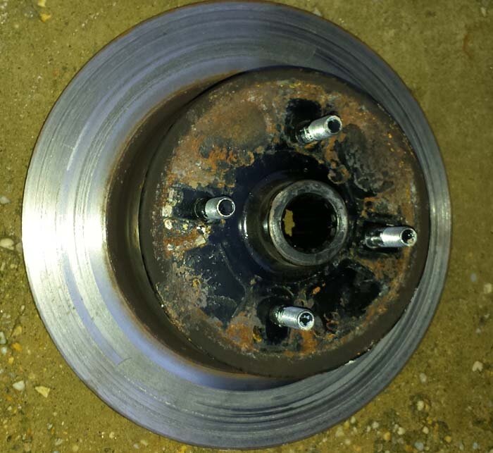

My back left disk which the pads dropped off and the piston rode against the disk and scored it was not really that bad. I could of used it as it was but I had the brand new disk/hub from Roadsmith, so I put it on and scrapped the damaged one. Photo below.
There was no doubt that the caliper was shot!! Piston face really tore up. Put in a new caliper.

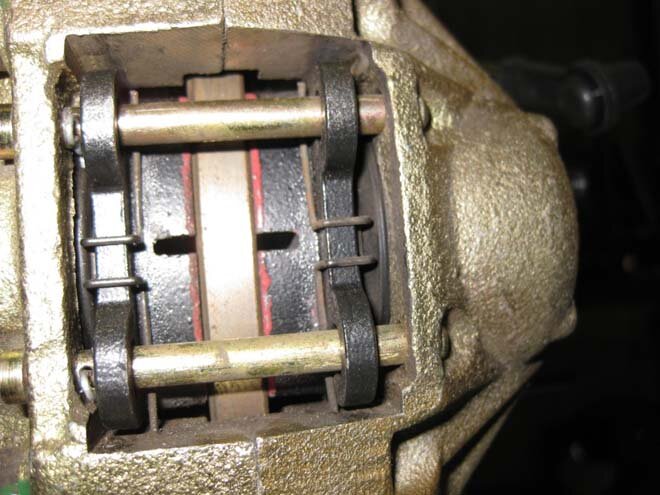

When the pads fell off, it was a real honest mistake. A few weeks ago when the pads put into the calipers (a previous brake job to repair a warped disk) the pad retaining pins were driven out and the small retaining clips could not be seen, probably because of the dust and some rust. The retaining clips are not on the ends of the pins, but inside, ie in between the inside of the caliper and the back of the pad. In the photo below (from Solidbob) the keeper can barely be seen on the left on both pins.

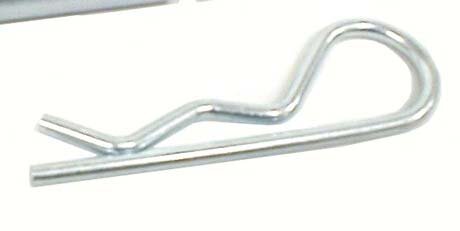

It doesn't make sense that the 1/16" hole is about 3/8" from the head, NOT through the protruding end. Anyway, that is how the mistake was made. (We thought the pad/caliper retaining pins were held in with friction, as they were a tight fit.) See photo below. Note, if you are doing your own brake job, carefully pull these pins and don't loose them. Instead of these pins, I used 1/16" stainless cotter pins, which should not have a corrosion issue.
