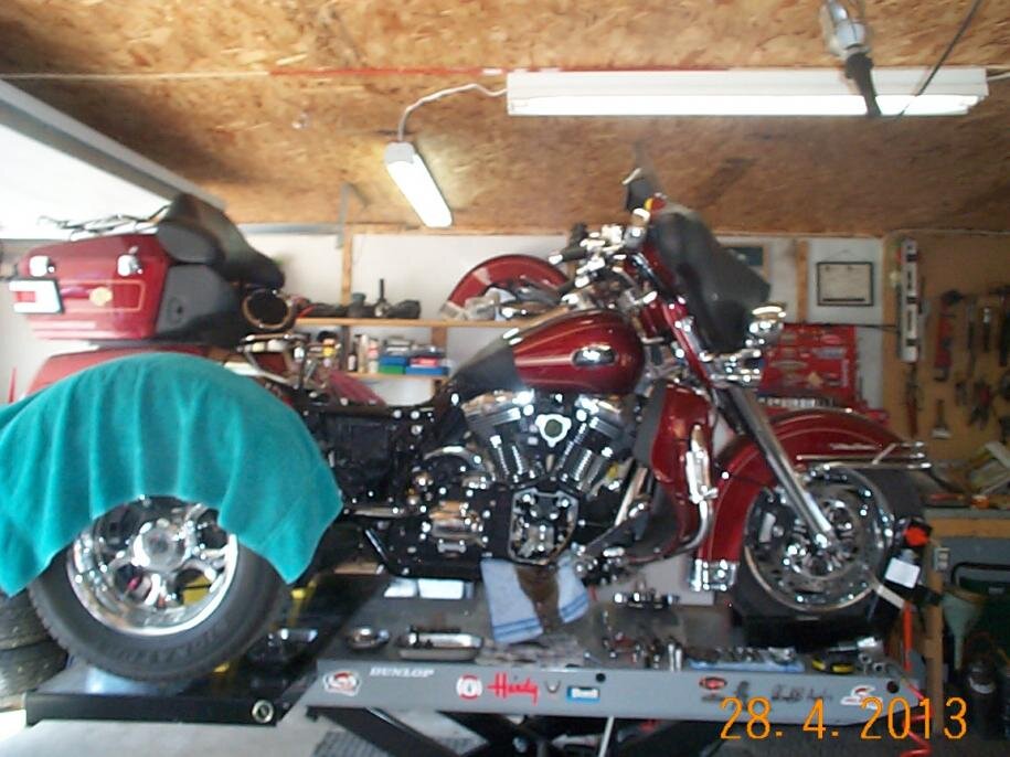

I figured I wouldn't disturb the oil pump by leaving it in there, and I did rotate the engine before final tighteneing to make sure it operated as before..
I used the adjustable pushrods because I didn't want to remove tank, rocker boxes etc..The quikie rods from S& S came with the 557 cams as a kit..
Iv used a lot of adj pushrods in the past and have never had a problem with them in the 40yrs Iv used em.
The engine fired right up, had the usual lifter rattle for a few moments and now runs a quiet as before...
Its was around 50F when I fired it up, and it didn't idle surge as it used too..
I can definetly tell there is more potato potato out the exhaust...

Two questions if I may...
Why did you not pull the oil pump out with the cam plate?
Why are you using adjustable push rods?
Just curious.
Nice catch, I just assumed he had already had the pump out and put it back in. I always pull my pump separate from the cam plate so I can inspect it. Leaving the pump in while pulling the cam plate only is kind of risky depending on the condition of the o-ring for the outlet of the pump, could have one that wants to sump due to the o-ring not being as pliable as a new one.
