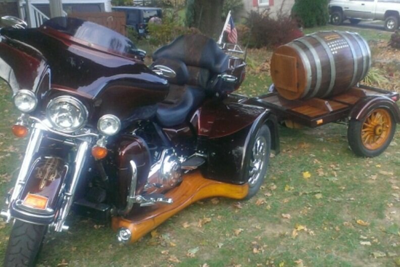

2009 Bike with 2013 Trike Conversion pulling 2010 trailer I built

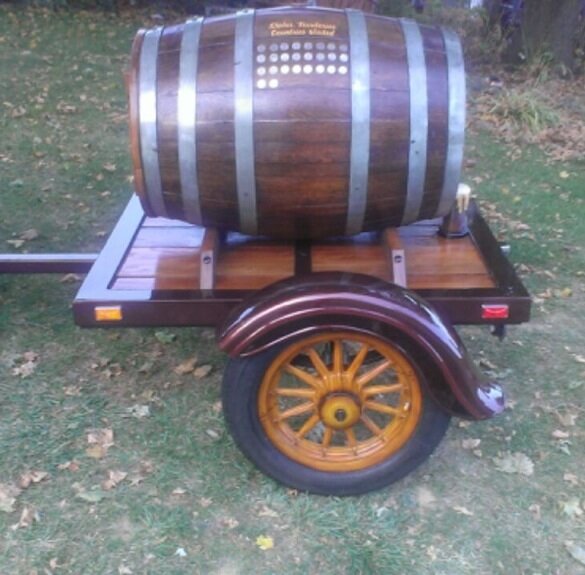

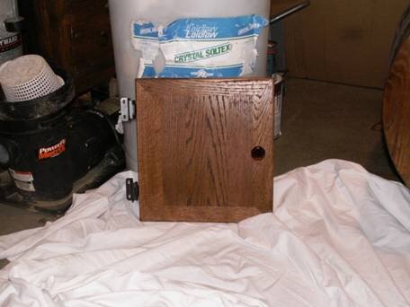

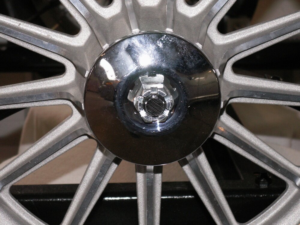

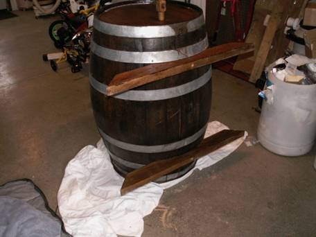

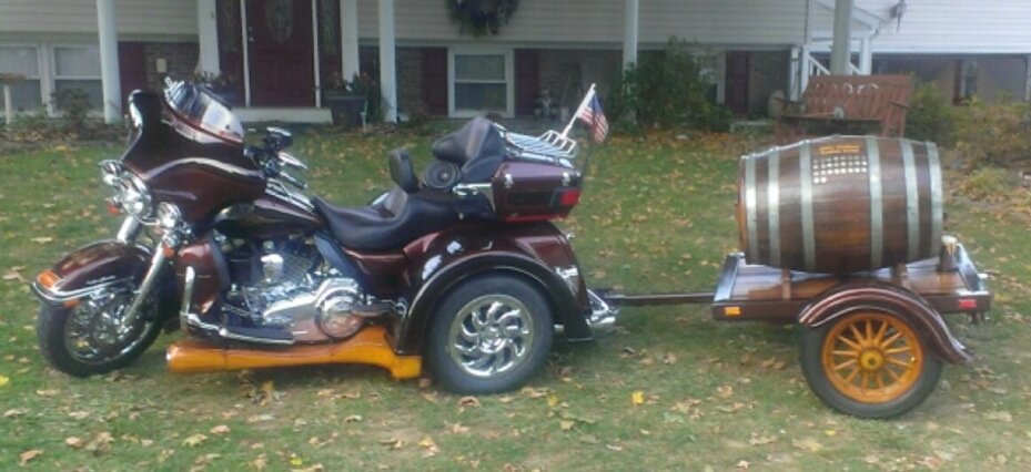

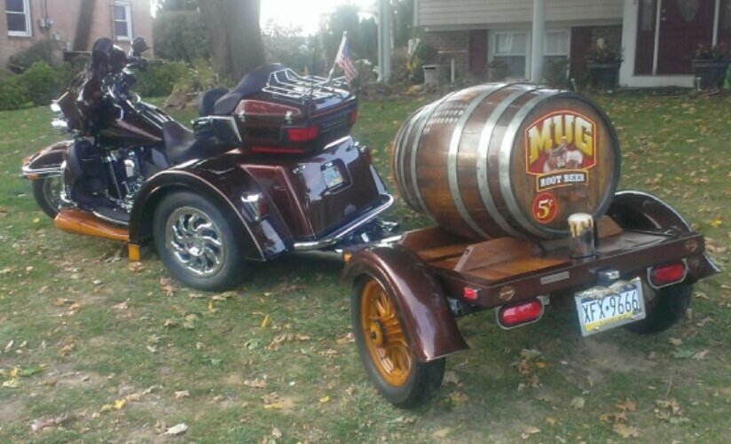

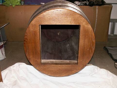

I built the trailer back in 2010 and pulled it behind my 2009 ultra classic. I started with a harbour frieght trailer made my own axle for a set of harley dyna glide wagon spoke wheels. I also bought a set of sidecar hubcaps for the ends of the wheels. I use a castle nut and a cotter pin to hold them on. The keg is an old wine barrel that i got for nothing at a winery that went out of business. I refinished the outside and sealed the inside with clear caulk to make in watertight. I then made a new end and attached that to the one end of the barrel, this allowed me to make my opening for my door on the end without the barrel fallinig apart. I then made a door that covers the opening so as to again make the barrel watertight. I attached the barrel to the trailer by making some stands that are made to the contour of the barreI. I used 3/4" oak boards to make the floor of the trailer and finished them the same as the barrel. The fenders are harley softail fenders that i got at a swap meet. I had them and the trailer painted to match the bike. I choose to have the mug root beer dog painted and got permission from Pepsi to do so. I dont drink beer but i do drink lots of Mug Root Beer....... Total project around $ 1,000.00

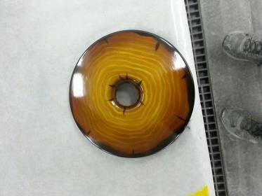

This year as i was trikeing the harley i had the wheels hand painted to look like wagon wheels then several coats of clear coat were added to protect them. This added $300.00 to the trailer

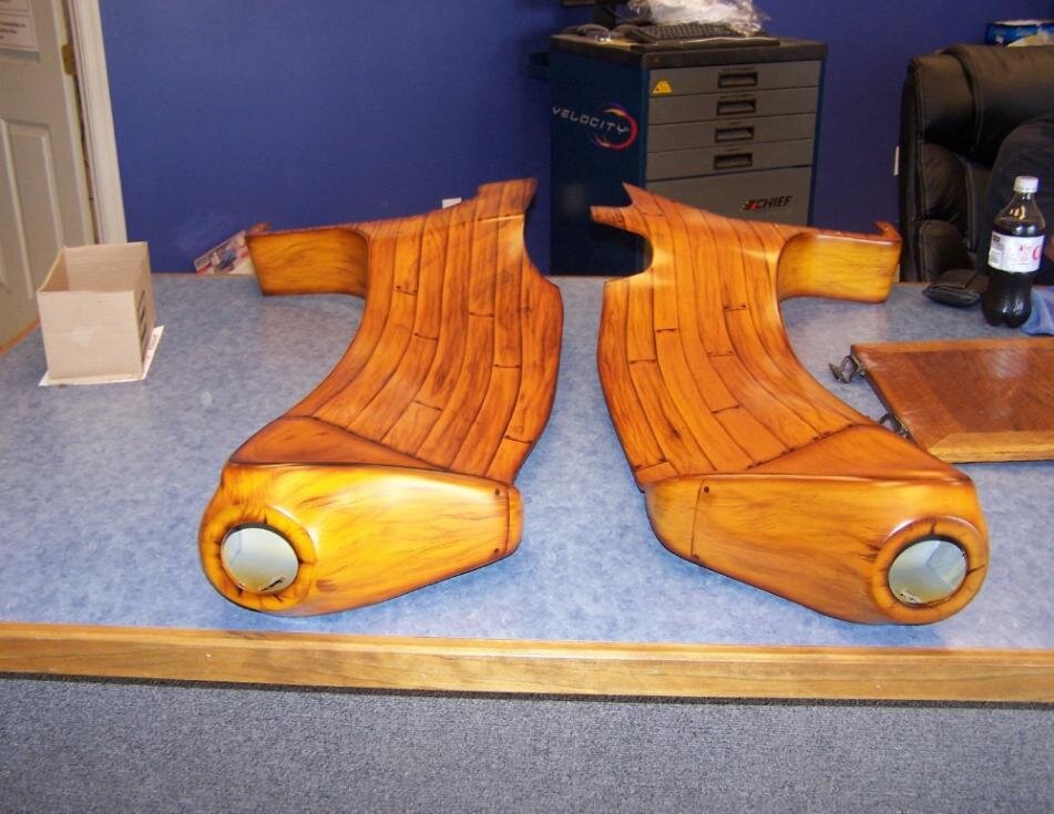

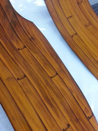

The wheels on the trike came from preformance machine they are called Torque. I bought all three to match, as well as the front rotors. The TROG TRAX (running boards) came from Motor Trike which is the kit i had installed to the ultra. I had the same guy who painted the wheels paint the trax, he painted them to look like a hard wood floor. I have better pics but cant seem to get them to load right.
