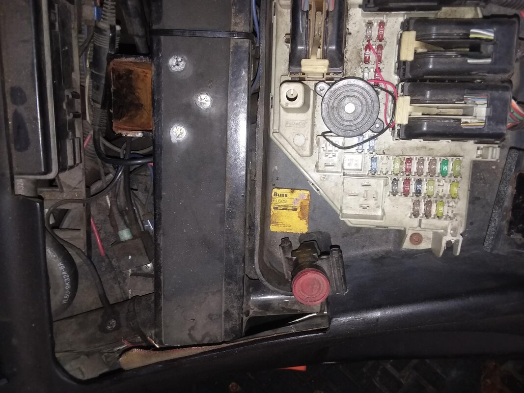

Roll over reset switch?
Since Stallions use Ford Ranger components, I would look for an Inertia switch
If I remember correctly Ford used them to cut power to the fuel pump
Look under the seat
Some looked like this and are reset able with the red button
