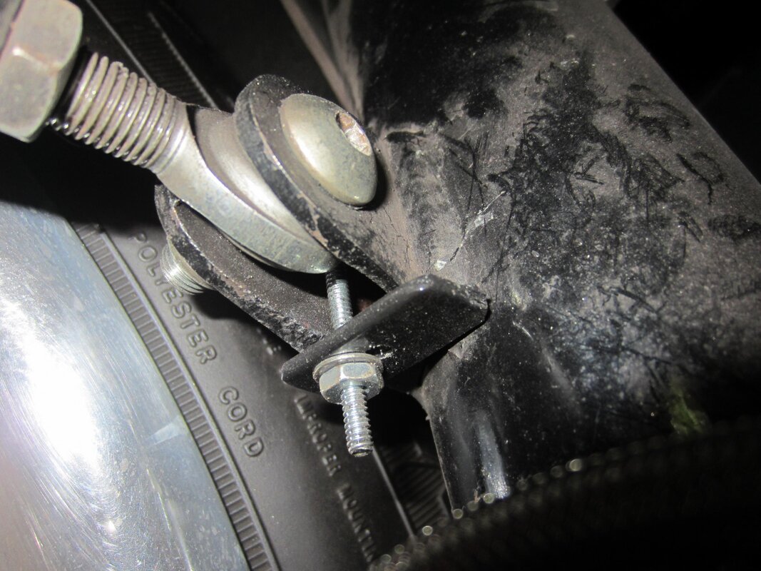

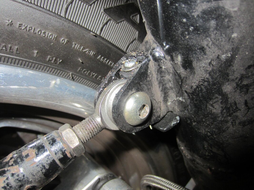

I'll tell you what I did to eliminate some of the rattle. One design deficiency is, the bolt that connects the rod end to the fork is an all threads bolt. So you have a threaded bolt going through a machined surface, which is a recipe for slop. I cut a rubber wedge from an old shock washer and inserted it in the gap between the rod end and the fork. I ran a #6 long screw through it and washer on the bottom so that it would tighten against the mount. This keeps the slack out of the rod end between it and the bolt. My rods do not rattle with this mod.

This is a mod I did to eliminate the rattle between the heim joint and the connecting bolt to the fork. I have a small rubber block inserted behind the heim joint. The end of the small bolt seen in the bottom picture pulls the rubber block down tight against the heim joint.
Caliper rod mod on Stallion 17 June '16 001.jpgCaliper rod mod on Stallion 17 June '16 002.jpgCaliper rod mod on Stallion 17 June '16 003.jpg
