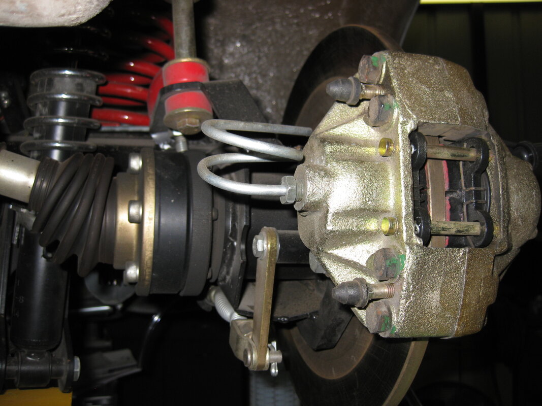

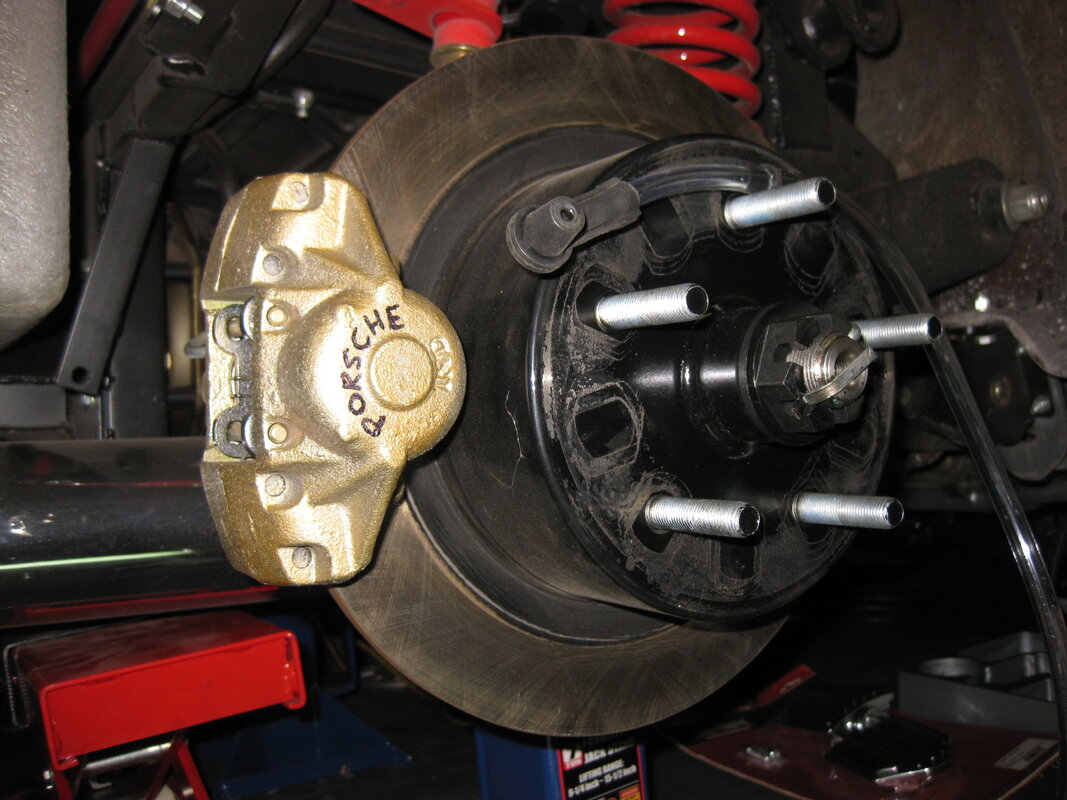

Well today I bled the rear brake lines.The rear calipers have two bleeder valves on them,so I started first with the left rear lower,and there was a lot of air,then I did the top one and hardly no air in the line. Then I did the right side and very little air top or bottom. Went for a test ride , and now I can lock up the rear tires if needed . I do feel safer with the braking now ,guess the dealer didn't test his work good enough. So I'll hook up the camper next week and ride 400-500 mile to see how it does with it on the back. Again thanks for the info on here ,I know no other forum on trikes with soo much help .

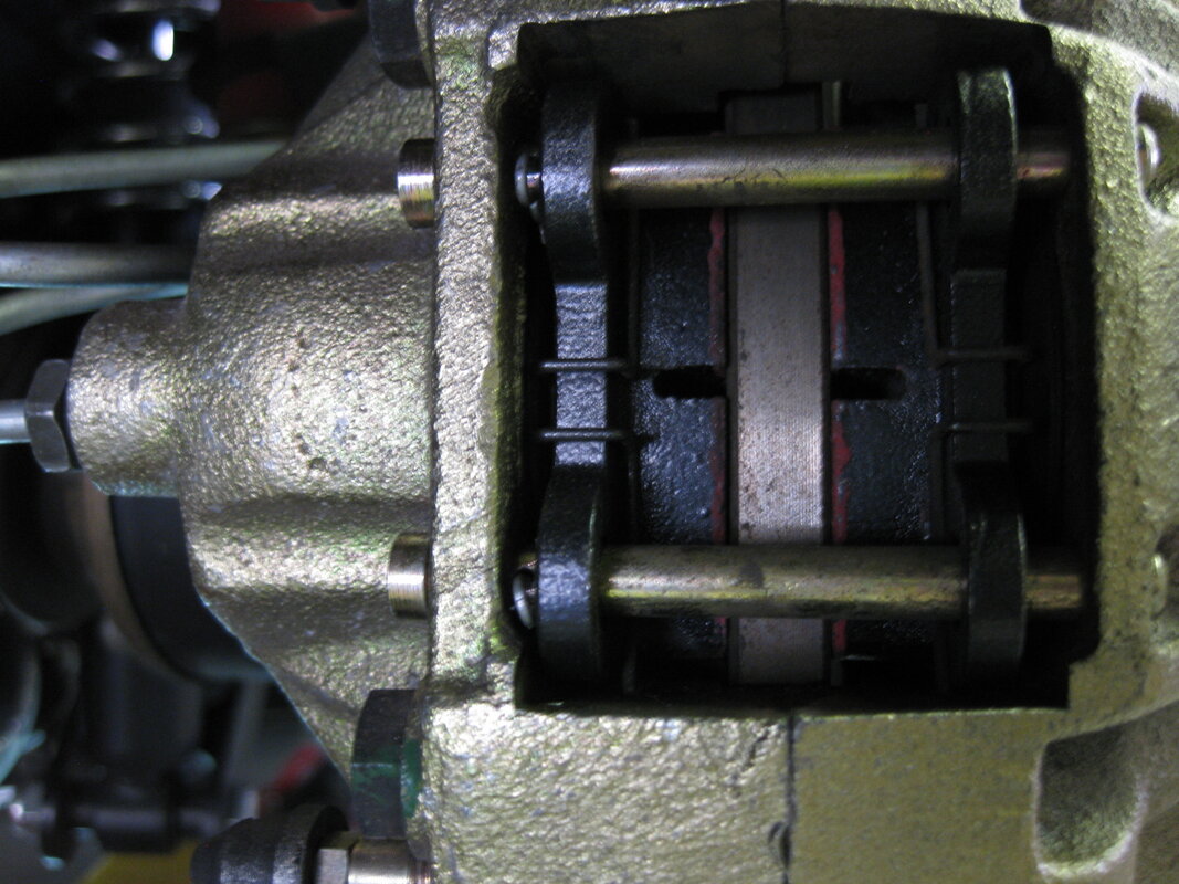

SolidBob, just saw your post #13, for whatever reason, I missed it. That's a file keeper for when I install the Yellow EBCs from RS. Thanks.

EBC Yellows just STOP once broken in..... lock them up anytime now!!
Great Upgrade.....
Yes Sir! I now have a few miles since I installed and broke in the EBC yellows. They are a HUGE improvement in braking compared to the stock ones I originally had on my trike. The pedal is now solid, not kinda spongy like it was, and like you said: Yellows just STOP the machine like they are supposed to. Yep, a great upgrade for sure! A big thanks goes out to whomever came up with this!!
