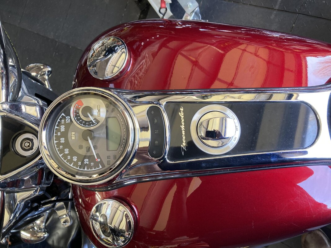

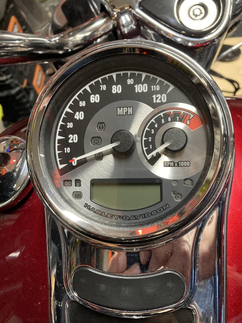

Well I finally pulled the trigger on the Speedo/Tach.
This is a similar model that I have on my 2009 Heritage however I found there are a few differences with this “Road King” model but nothing to really speak of.
The installation took about 10 minutes.
As expected there’s no parking brake or reverse indicators so you’re kind of on your own there.
However for the reverse as you know you have to be in neutral to go in reverse and when in reverse the “neutral” light goes out so that’s my new “in reverse” indicator.
As for the parking brake; I’ll just have to remember to disengage it.
Any way I really like the gauge that’s been on my Heritage for years and I have no doubt I’ll like the similar version on my Freewheeler.

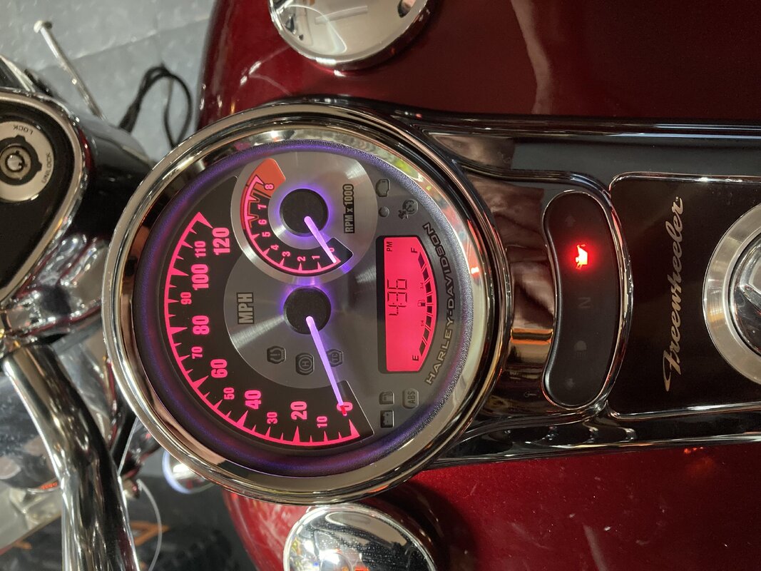

Blueraven that's awesome! Does the gas gauge work? Do all the indicators do what they're supposed to do? Does the switch on the left grip still cycle through the clock and all that stuff? Where did you get it and what was it originally designed for? I can live without the reverse and parking light indicator, as you said and that looks like a real worthwhile swap. Very nice! :D
Everything appears to work as it would on a Road King.
Everything is controlled with the thumb switch on the left grip.
It has the ABS, tire pressure sensor and traction control indications but the 2016 Freewheeler doesn’t have those features so they’re just dimmed out.

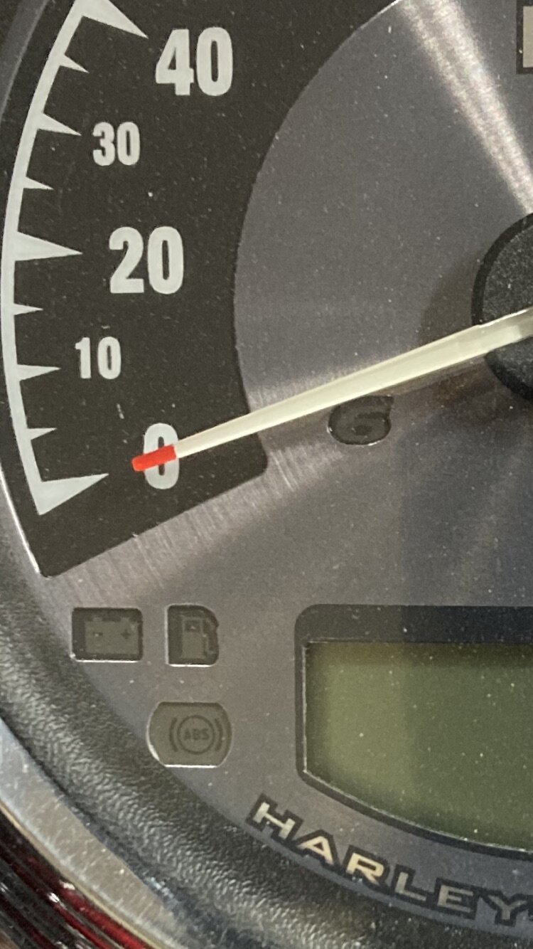

As for the “6”; that’s to indicate you’re in 6th gear however what’s picture on the Harley site is what appears to be the older model which is what’s on my Heritage.
The model I got for my Freewheeler which is for the newer Road King does not have that “6”.

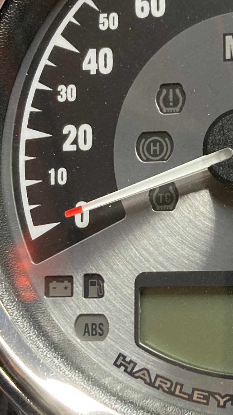

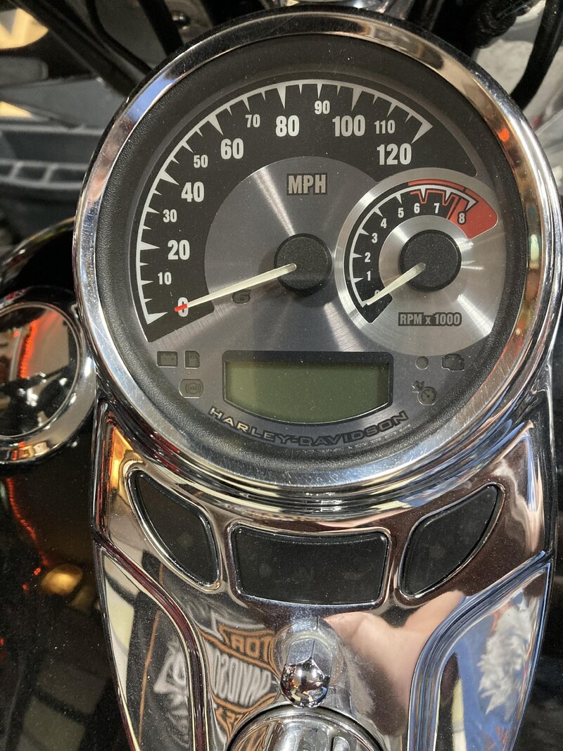

Here’s a picture of the older model that’s on my 2009 Heritage:
Here’s a picture of the newer model that’s on my 2016 Freewheeler:
Instead of the “6” the newer model has warning lights for “low tire pressure”, “vehicle hold control” and “traction control.
They both have the “ABS” indicator even though a slightly different icon.
Left- older model—- Right- newer model

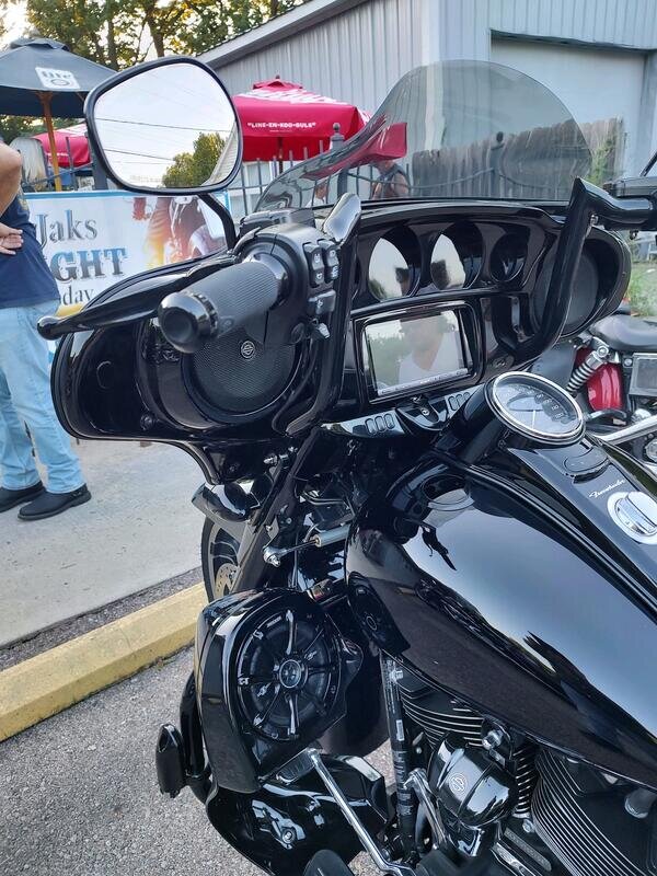

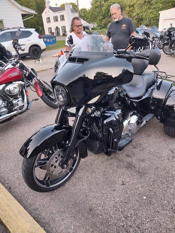

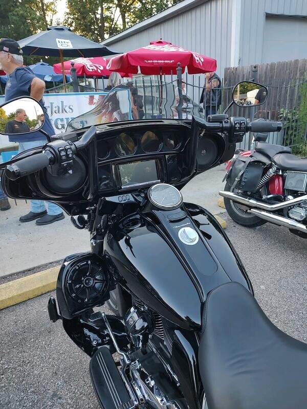

Drove past a Freewheeler today on the highway and they had what appeared to be a Triglide or some bagger fairing on it. I could tell by the gauges.
Anybody seen that before?
My buddy's 2019 with a factory Street Glide fairing.
