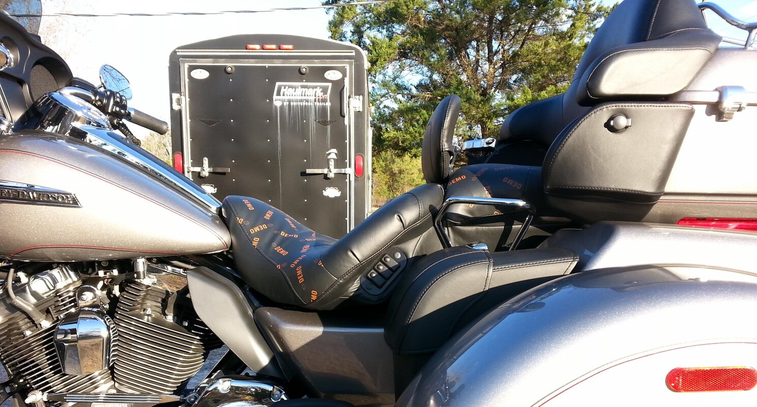

Here's a snapshot of the Demo Road Zeppelin with driver and passenger switches on drivers seat. It's P/N 52000201 listed for 08/later Touring and 09/later Tri Glides. Haven't seen anything from Harley that addresses changes, if any, from previous seats with P/N 51072-09.:Shrug:
Yes I agree that is exactly what my seat looks like. When I bought the seat in March of 16, the box it was in and the receipt showed PN 51072-09. I checked online and that part number has been updated to the 52000201 you listed. Makes me wonder what the difference is between the two. The 2017 and 2018 P&A catalogs shows the vinyl seat still using the PN 52000201, but the buttons are different. It has 2 buttons up front and 1 on the passenger seat. Oh well! :)
