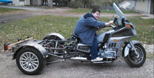

Took the Trike out for a ride, about 35 miles, and I'm very pleased. Need to check the speedo, looked down and was surprised I was going 70 in a 55. Didn't feel like 70. Lots to do yet. Still having fun.pepper

Well my friend that is surly a different looking ride, Whats the plan for the back end?
I have seen tents that extend off the back of a pickup and there are an assorted choice of things you might do?

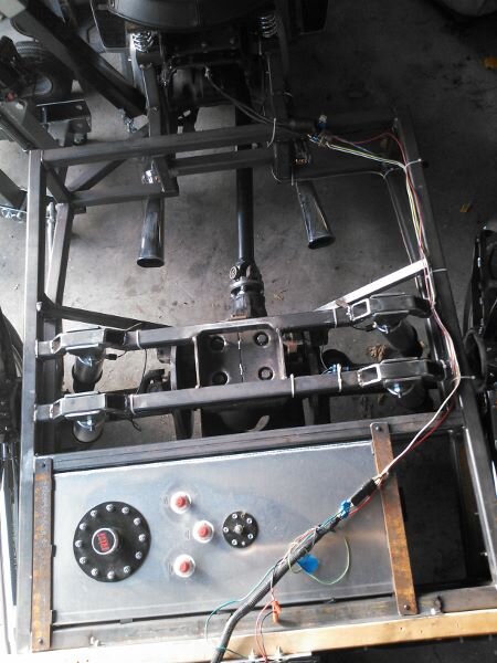

Thanks everybody, here is a list of my last activities on the build and some explanation of where I'm going with the build. I've had very little back tracking so far.(list is from another site I'm on)

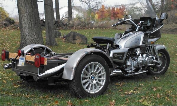

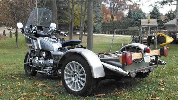

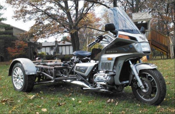

Hi Everyone, I've been doing a lot of things that won't show in pictures to get the project road worthy(to reduce Head Wobble that was a little more than bothersome), and some things that will.
New outer wishbone bearings on the IRS.
Corrected a loose inner wishbone mount.
Alignment of wheels to frame and each other.
Installing the four Progressive 416s in place of the coil-overs and plumbing to the GL onboard compressor.(some frame rework)
New Progressive Fork Springs+spacers to regain ground clearance.
New fork seals and dust seals.
New All Balls Head Bearings.
Adjust steering effort to slightly above spec.
Scraped the idea of the combo electric reverse/alternator drive.(Back-Track, Budget took a hit on this)
Turned spacer with pilots to replace pulley for that set-up.
Installed Fuel Cell.(not plumbed)
Installed Fenders.
Put Covers back on.
Removed the Anti-sway bar.(Back-Track, not a big hit, don't think I'll need it. If I do it will need to be a lot lighter.)
Probably a few more things, anyway, I road about 35 miles yesterday and am very pleased with the outcome. Going to check the speedo with a GPS, looked down and was surprised I was doing 70. (didn't feel like it) lots more to do. My Grandson says he riding to Canada!

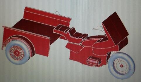

The computer image I did before I started to get a feel for the project, finish will be something like that.
The void in front of the IRS will be trunk space and the void beside the fuel cell might be an auxiliary battery location.(if I do the add on alternator).
The bed will lift to provide fuel/trunk space access.(Trunk will have a sealed lid) I have Harley Police seat that's shaped like the Cross Bones seat I have mounted but a little larger that will mount on the bed, a little higher in a kind of King/Queen setup. Hopefully Queen will get a back and arm rest if I can make it look right. Thanks for the interest. Perry
Wheels, you keep goin my friend, lookin good on Big Red! Yes, the rain stopped and we are to get a little snow tonight. Won't stick, just a reminder. I'll do the speedo check on our street so I don't have to ride the mud road to the Highway. If it's good at 25, it should be good at 70.(I think)
Can't wait to see it done. I would think about 35 MPH would give a better indication of true speed. Most are off by 5 MPH. Yes at 60 on a Gold wing trike it feels like u are doing 30. At 95 it is a different story however. Speedo should not be effected by the trike mod. Speed comes off the front wheel.
