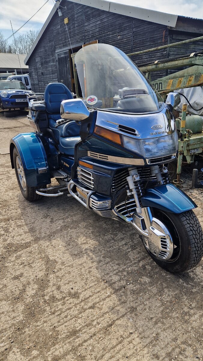

The EMG wheel and forks were designed to use a car tyre.
Unfortunately the idiot that did the conversion used an asymmetric pattern that had a tendency to follow ruts.
During the strip down and refurbishment I fitted this symetric tread and on first ride it definitely felt much better.
Will put I in some miles over the weekend and get a better feel from it.
