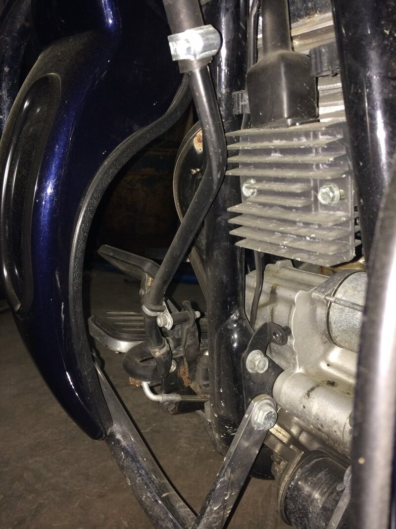

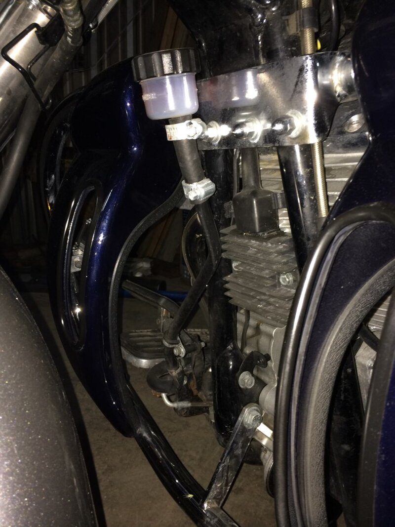

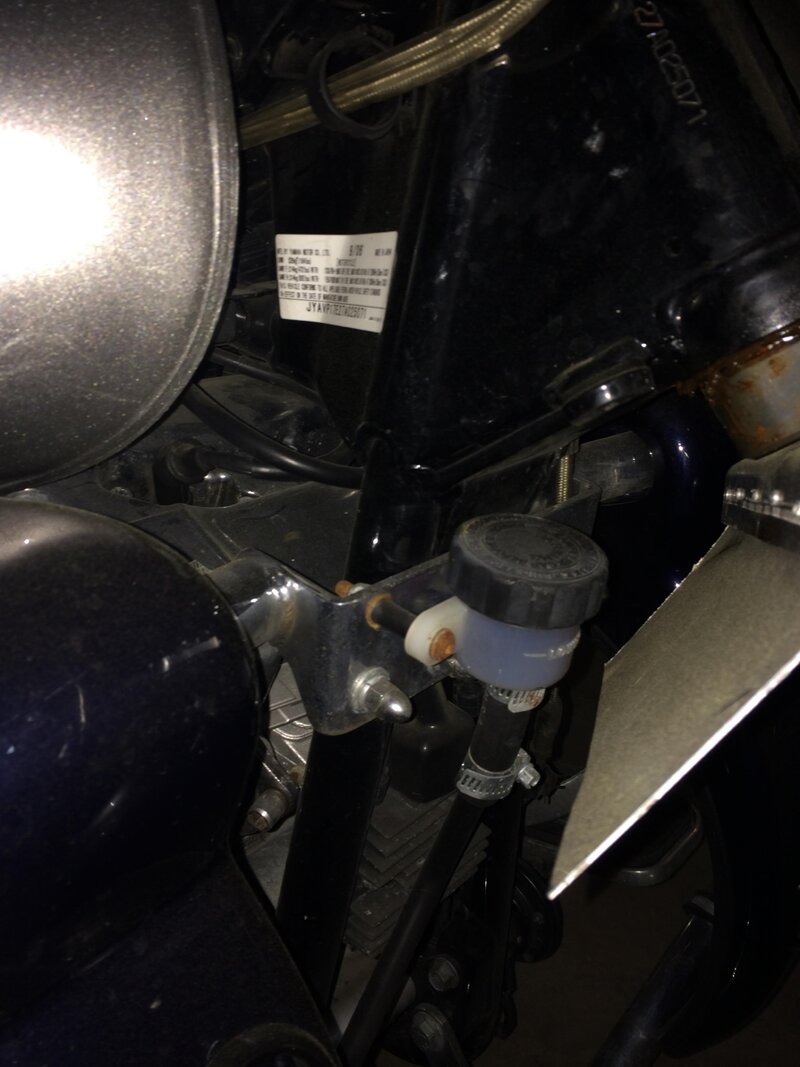

On my Yamaha 1700 Road Star, moved the fluid tank up above the back wheels. Removed the valve.
It fixed the soft pedal problem. Will see if I can find the pic. and post it. They are connected with a hose.
May add Champion did not like it, it fixed the brakes. Not their design.
saab9k - what did you use for the hose connection from the master cylinder to the fluid reservoir when you moved it up?
A fuel line. Will look for picture.
Used a piece of black pipe in the middle. To get angles right.
Been like this for 2 year. No problems. Great brakes.

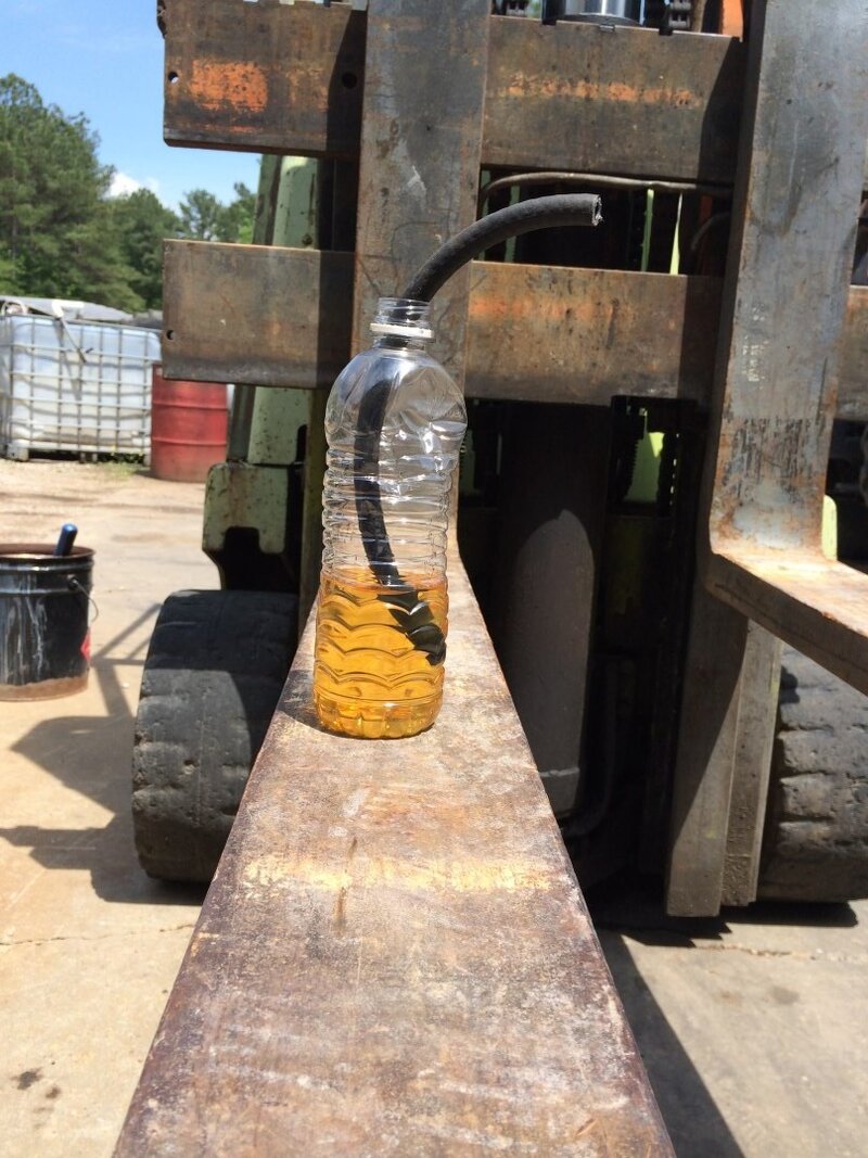

Remove rear wheels, open screw, let the brake fluid run thru a plastic line in a bottle with fluid in it. Keep adding fluid, so all air get out. Start on left wheel. pump brake pedal very slow, pause between pushing pedal, give fluid time to refill master cylinder.
It will work.
It will work.

This is a fix forever. Some people don't understand. The reservoir has to be the highest point for free flow. The valve on master cylinder is not a fix there will work all the time.
Remove it. Use 2 hoses and a piece of steel tubing, bleed it one time and smile.

Hook hose to upper bleeder, make sure hose is in brake fluid.
It will bleed all air out, gravity feed fluid from reservoir.
