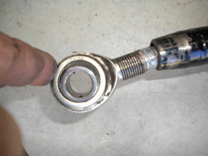

I found the left hand side heim joint on the swing arm joint of the ladder bar had flogged out. I thought I had tightened it before our big trip across the country (Australia - easy coast to west coast over 10,000 km done in 30 days). When we arrived back home I started doing some post trip maintenance and found the nut had backed off again. On deeper inspection it was the heim joint flogging out the threaded welded nut on the ladder bar:
So I was able to purchase a threaded insert from a local hot rod parts supplier along with the 5/8 heim joint and some silicon spray. Took the ladder bar to my brother in laws shed and drilled out the offending bit and screwed in the insert and the heim joint. When I started assembling it back onto the bike, I found that the distance from swing arm pivot to the rear section of the ladder bar was around 30 - 40 mm out compared to the other side of the bike. This has now been fixed, and the bike feels much better in corners.
