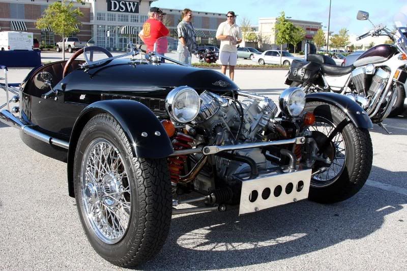

Here is a link to a vehicle about like your design. Maybe it will give you some insight on a working platform. You have a good looking concept. Good luck with the rest of your project you have a long road ahead. Keep us posted!<br />
<a href="http://www.youtube.com/watch?v=qEAadQkhXr0" target="_blank">http://www.youtube.com/watch?v=qEAadQkhXr0</a>
