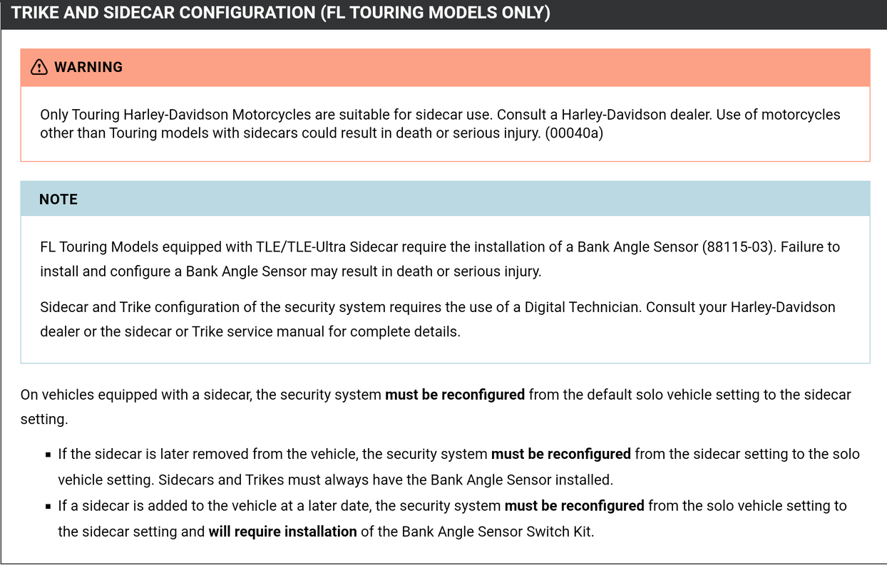

In the Smart Security System Installation Instructions under Trike and Side Car Configuration.
There's a Note which states:
Sidecar and Trike configuration of the security system requires the use of a Digital Technician. Consult your Harley-Davidson dealer or the sidecar or Trike service manual for complete details.

The lean, fall over cutoff portion of the program has to be adjusted for the trike side car.
understand....the configuration of Bank Angle Sensor is also addressed in the same Security System Installation Instructions. Here's a short extraction....
