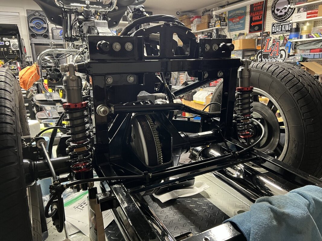

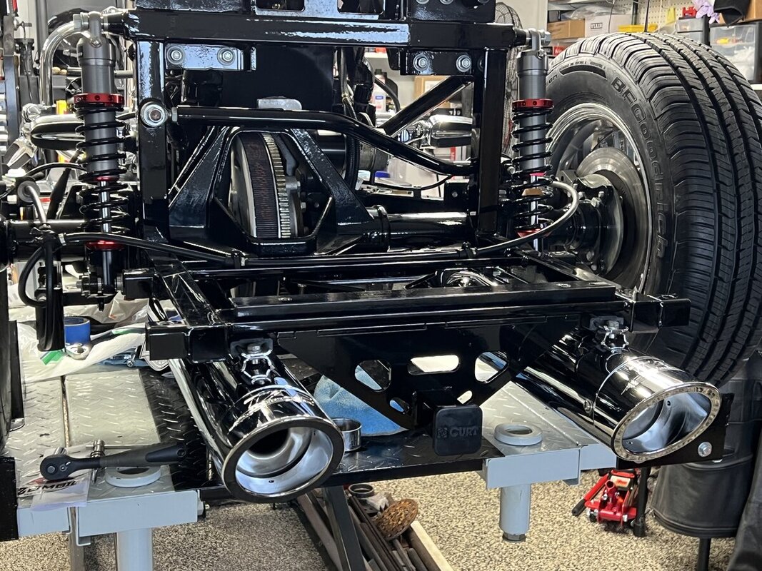

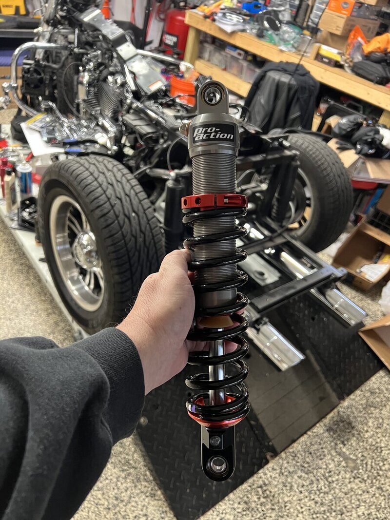

I replaced the rear shocks on my 20 Tri Glide with PRO-Action 14" and lift from DK Customs. No mods needed. I have over 40,000mi on these shocks and best thing I did for ride comfort. I understand the NEX-Gen shocks from DK Customs are the next best thing for the Tri Glide.
Get ahold of DK Customs for more info on what works best, they test all of their products in house
ProAction 14” shocks work perfect.
In fact they do not recommend using any “lift or comfort” brackets. They simply are not needed per George at ProAction.
Just bolt them to your stock brackets. I’ve had their shocks on my several previous 2 wheeled bikes too. Excellent quality and customer service and lifetime warranty too.
(I’ve also heard good things about the DK Nex-Gen shocks too).

The 14" Pro Action shocks you have are shocks we co-developed PA, and they score an 80 on the comparison chart. The are specifically for HD Trikes, whereas the 12 & 13" PA shocks (Street Series) are for 2 wheel bikes, and we did not have a hand in developing those. Among other differences, they do not have as much travel, nor as heavy a spring.
The 14" PA shocks you have were designed to work best with a Convertible Comfort Mount. They put the shocks at a bit more of an angle and absorb the bumps better. PA says not needed (now, that is not what they used to say), because they got a little tweaked when we started making our own shocks.
Everyone's butt dyno is different, but I believe you will notice a difference...whether the difference is enough to justify the expense is only something you can answer.
I will let you know that we spent over 1.5 years making the NexGen™ shocks, and what we were chasing, and did not give up until we achieved it, is that the NexGen™ shocks had to ride noticeable better than the PA shocks. If we could not achieve that, then there was no purpose in making them, because we already had the co-developed PA shocks.
