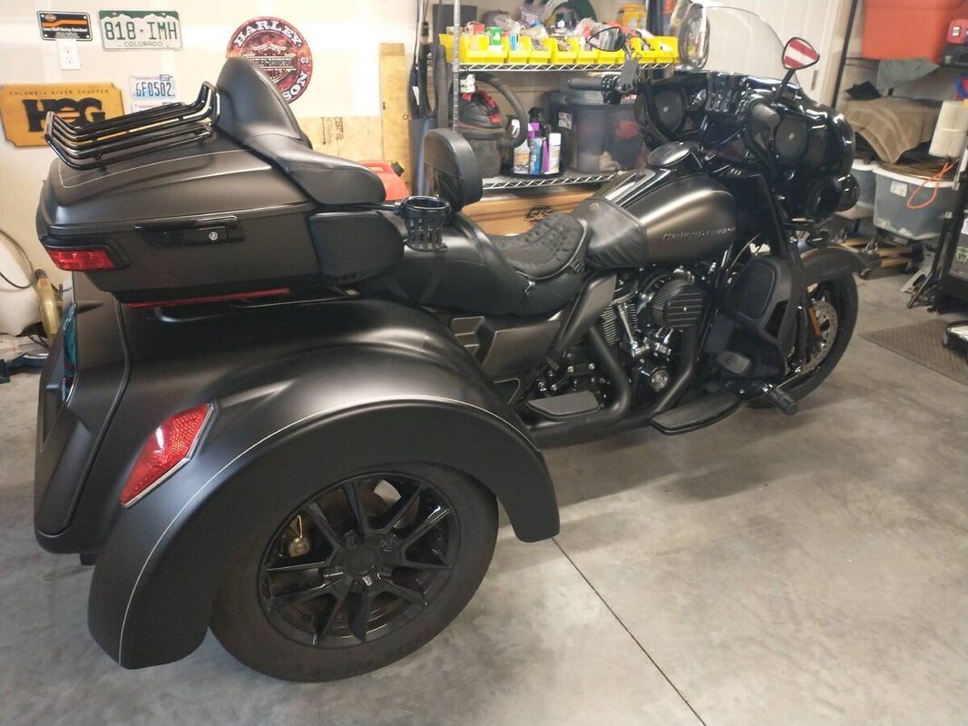

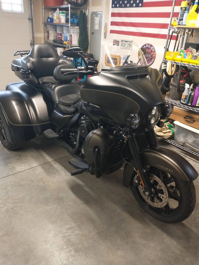

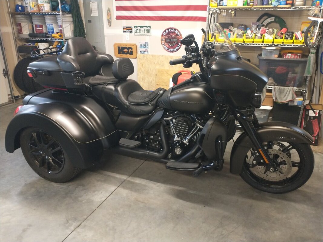

I know everybody likes the 2+2 sweepers and I understand, I went with wild one 12.5 bars and very happy with them, I rode a trike many years ago that had these bars on it, loved it so that is why I went these from wild one.
