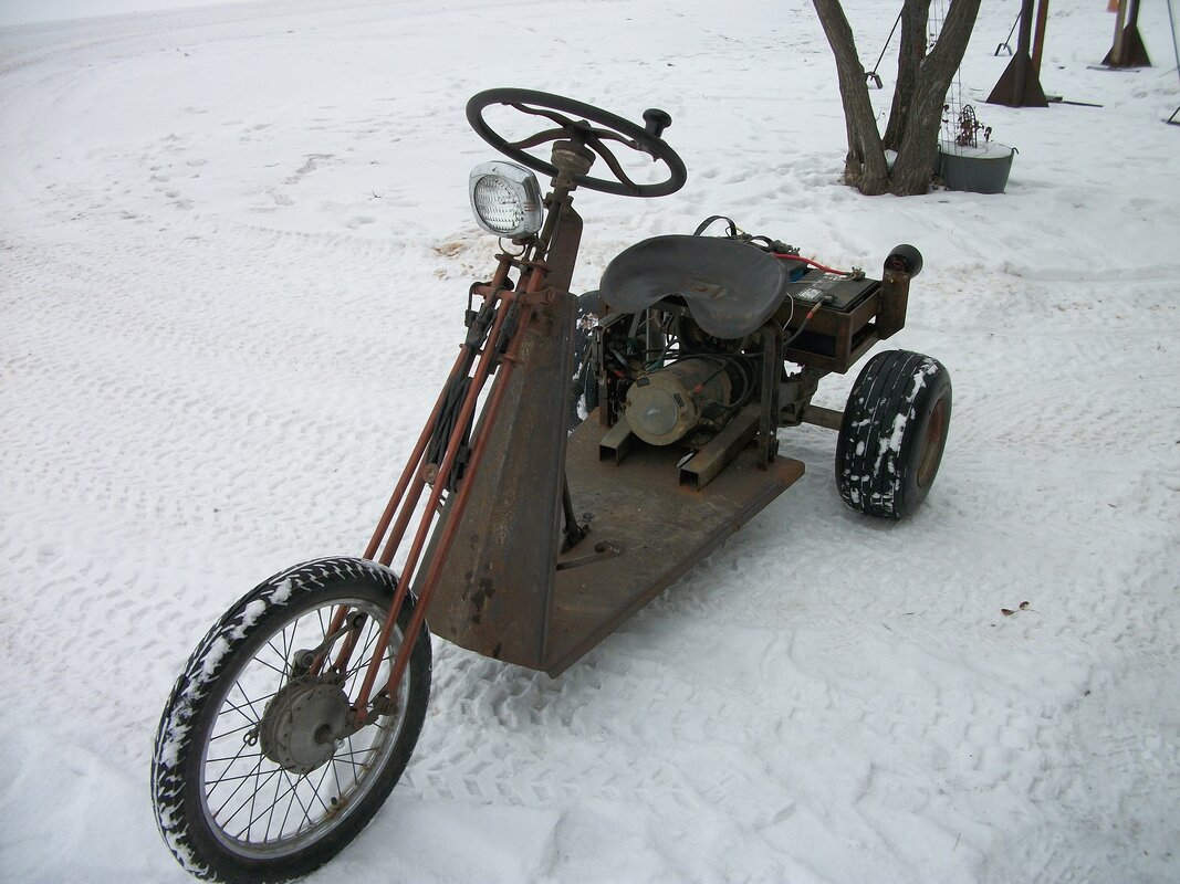

Thats a cool trike for sureThumbUp
Now all he needs is chains on the rear tires, & a ski in place of the front wheel, & he's got a year round playtoy!!!
that's a model T steering gear, not model A.......planetary gear reduction maybe 3 or 4 to 1 depending on yr. seemed a little too lightly built for a steering gear on a road trike...I do think a heavier planetary reduction could work on a short wheelbased trike. maybe, on my next one!! larry

View attachment 40336electric trike with model A steering gear.... homemade springer with bungee cord spring. just a yard trike.....built several yrs ago....thought of using steering like this on last winter but didn't. larry

diver .....here's hoping you can post some pics of your electric trikes. 60v /500a that's some serious power! the redneck rascal, is just the rear end of a 3 wheel golfcart 36v with homemade front. good for buzzing around the yard.....kids have fun with it. larry
