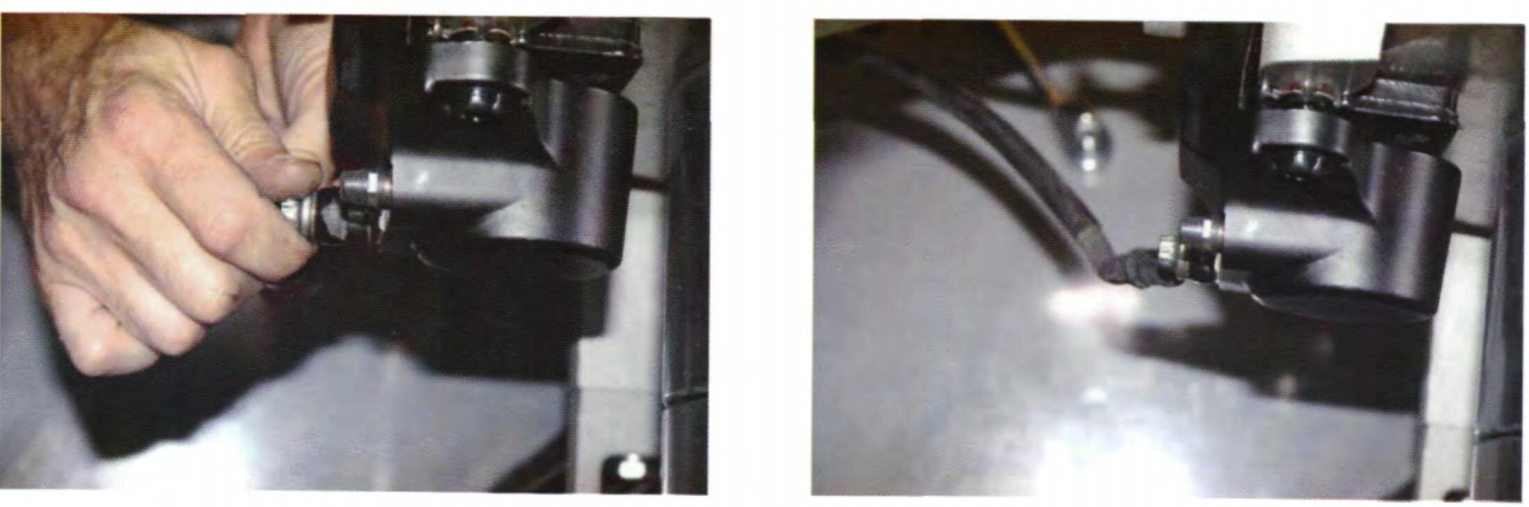

But to the question of weak braking after recall, it is important to properly bleed the brakes. Usually the trike manufacturers provide special bleeding instructions due to modifications to the rear brakes because an extra caliper is added. But there is still one more procedure that doesn't show up in either the Honda manual or any of the trike instructions. It has been labeled the "Rocky Bleed". Many times the weak brakes are a result of some air still left in the system and the "Rocky" method helps to eliminate all the air and will probably firm up your brakes to where they should be.
https://www.theglforum.com/forum/mo...-brake-and-clutch-fluid-flush?p=6033#post6033
