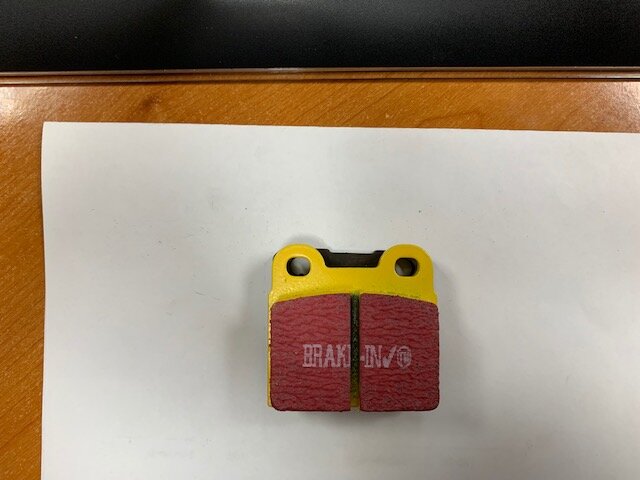

As many others have stated, the rear brakes on the Champion are very weak at best. (VW parts) Step on the rear brake and you can kinda feel it trying to slow you down but not much more than that. So, I bought the new Yellow Stuff DP4105R that every one says is the replacement for the stock pads on my Champion Trike kit. However, they are a different shape between the pin holes. BrakePad2.jpg As you can see, the "cutout" between the hols is much deeper.
That cutout is where the anti-rattle clip fastens to the pad. Since the cutout is deeper the clip will not work. I've been in contact with EBC (who have been very attentive) and they can not come up with an answer.
Has anyone else had this problem? What is the fix? Are there other clips that can be used? Are the clips really needed? Any suggestions will help.

Hi Mark......I also have a Champion ( my Lehman kit says it’s a Lehman....but it’s actually a Champion IRS)
Although the brake components are Nissan ( from Acura ) they, like yours are not really
effective.
When I put new pads on my trike 3 years ago.....I too installed the EBC Yellows recommended by others on this site.
As it turned out, the yellows were not great. If you talk to EBC, or go to their web site, you will find out that the EBC green pads are made of a softer material that is designed for lighter vehicles.
I actually went to a Carquest pad recommended by Lehman that is Sintered. It has noticeably improved my stopping power.
No more EBC Yellow for me!
i know that this doesn’t help you with your clip issue....but I thought I might warn you about pad selection.

Thanks for the reply. EBC is sending me some pads to try so I'll give them a shot. However, do you have a part number for what you used just to get me in the ball park?
The EBC pads for my trike (which won’t fit yours) are DP-21987 Green Stuff. They are designed for light vehicles. These are the recommended pads for my Lehman LLS which is actually a Champion IRS.
The EBC Yellow Stuff is a harder pad....not ideal!
