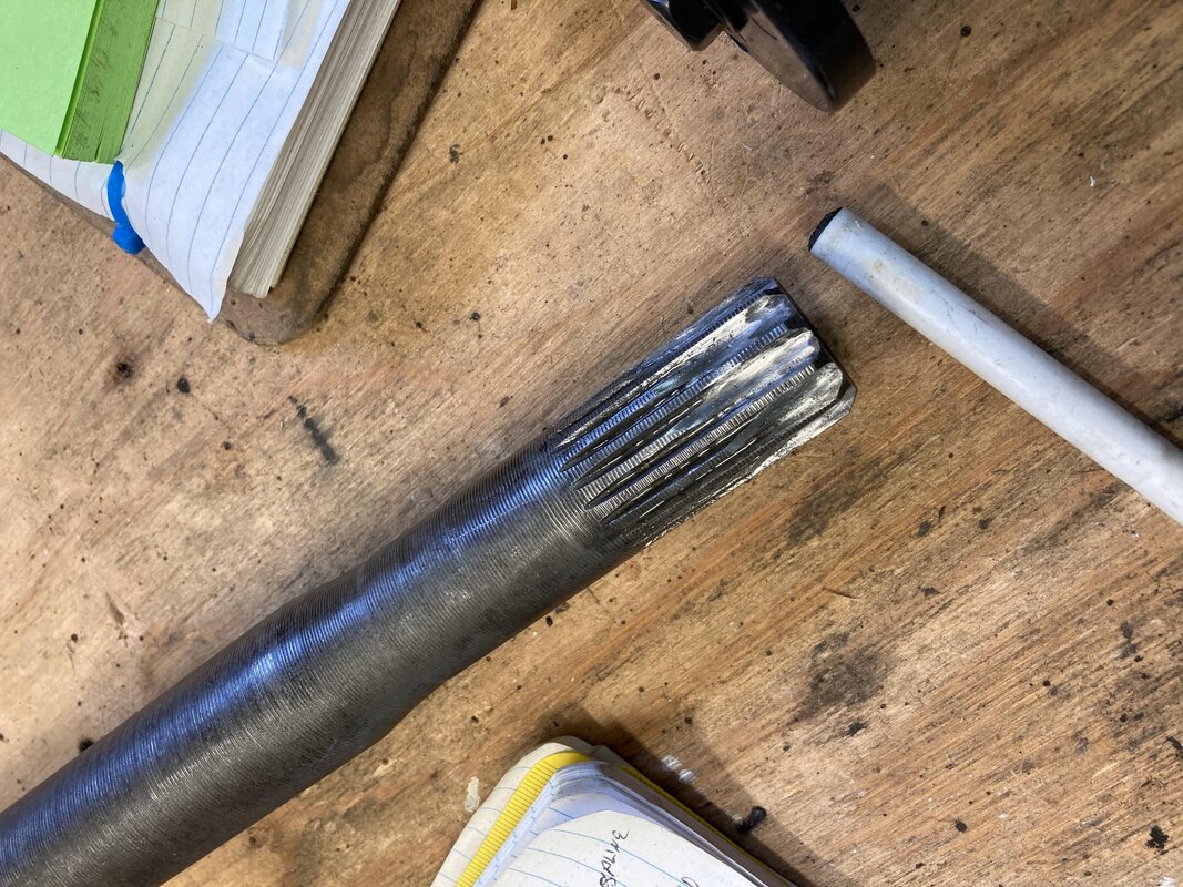

How can I find out what vehicle the axle shaft used On trike is from?

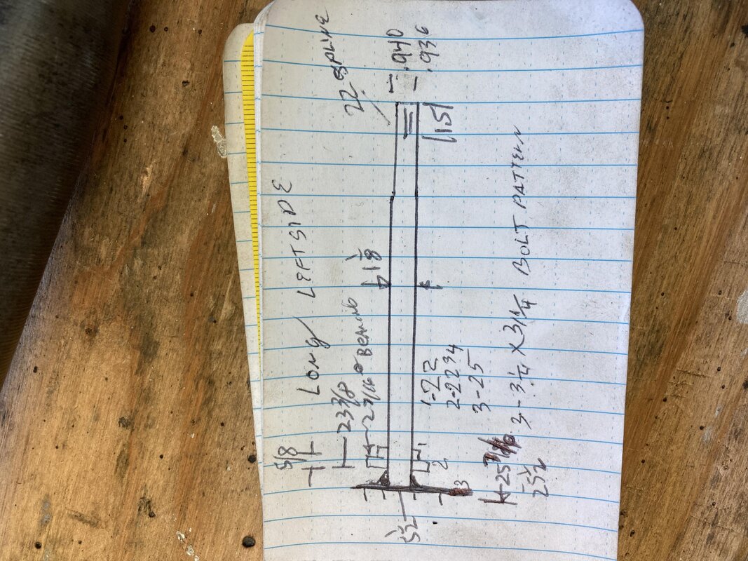

Sorry about lack of info. I am helping a friend figure this out and I am a bit slow to figuring out how to use this site on a cell phone that I am not great at using. I know it’s a champion conversion and pretty sure it’s a Honda and he acquired it 2011 but thinks it might be pre 2006. The axle plate where tire attaches has scallop on two sides. The axle housing is offset so axles have different length. This one is close to 25.5” long measured from tire side of plate to end of axle. Would post picture but cannot figure out how

the messed up shaft is on left (when sitting on trike)

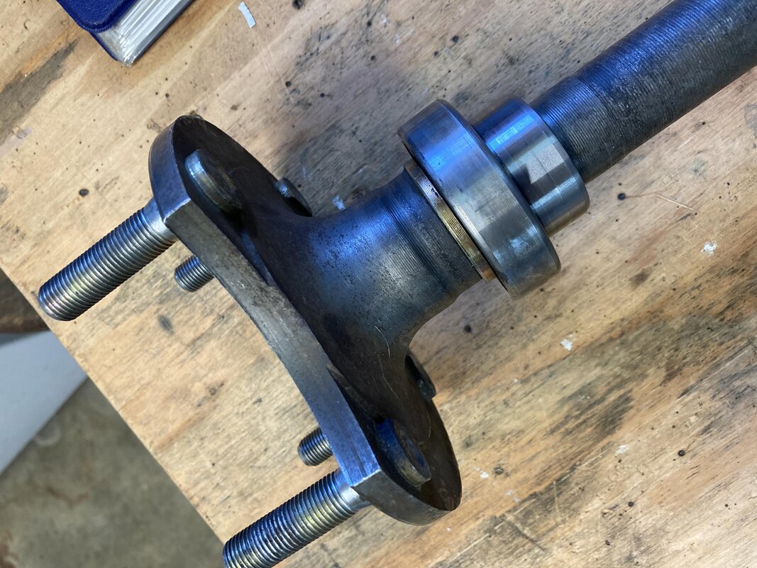

the scallop on plate seems to be a defining thing
have been trying to find axle going with the scallop but have only seen one
But it had 4 scallops instead of 2

The axle pictures ere great!!
If you can post more pictures of the rearend, and the trike back end we may be able to help you much more.
What is the problem with the left axle?
