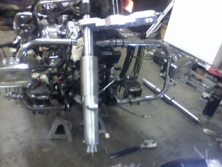

here is something i wanted to add.
THE TREES COME WITH A 2 INCH EXTENSION TO ADD TO THE TOP. THEY ARE A BIT DIFFICULT TO INSTALL DU.jpg
ThumbUp THE TREES COME WITH A 2 INCH EXTENSION TO ADD TO THE TOP OF THE TUBES, THEY SCREW IN, THE TOP NUT IS A BIT DIFFICULT TO INSTALL DUE TO THE FORK SPRINGS.
:Shrug:YOU MAY HAVE TO USE A VISE TO HOLD THE TOP NUT TO HELP IN COMPRESSING THE SPRING.
I HAD SOME HELP AND WAS ABLE TO DO IT WITH MY OWN ARM STRENGTH.ThumbUp
NOW IS A GOOD TIME TO CHANGE THAT FORK OIL! ThumbUp
:10: THE TUBES SCREW INTO THE UPPER TRIPLE TREE,SO NO CHANCE OF TUBE MISALIGNMENT OR FOR UNEVENNESS.
SCREW IN HAND TIGHT ONLY, SO PUT AWAY YOUR PIPE WRENCH BOYS. I REALLY LIKE THIS FEATURE, ThumbUp THERE IS NO CHANCE AT FORK MISALIGNMENT AND THE UPPER FORK CLAMP IS ELIMINATED
