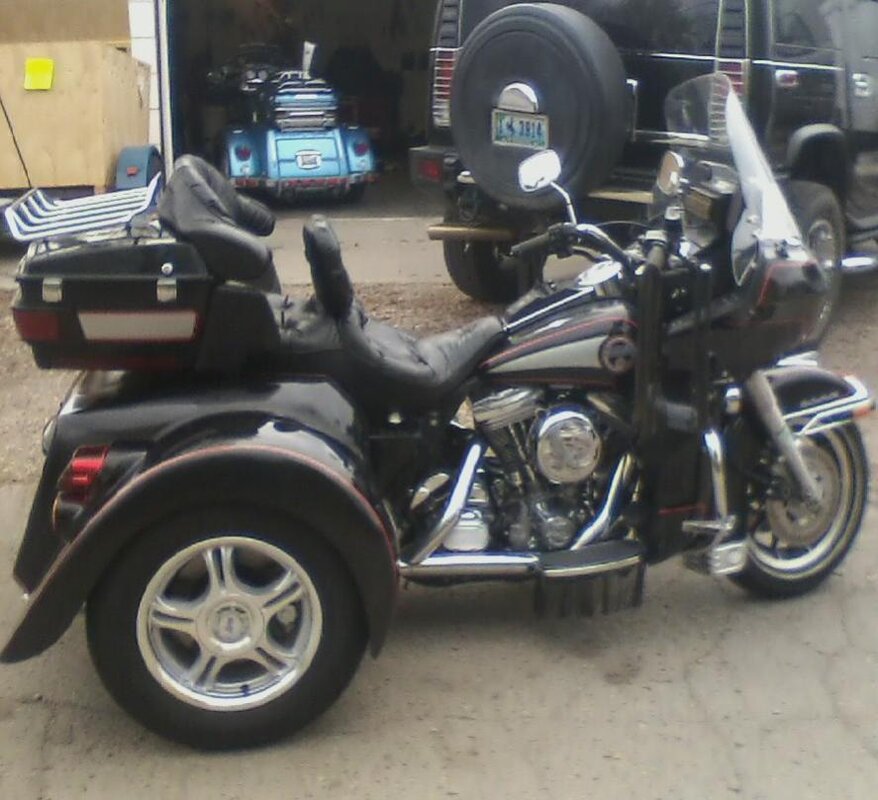

:Coffee: I bought both my rake kit and champion trike kit through zook.
I had just joined the forum and was nervous about sending someone i didn't know that much money off my credit card.:xzqxz:
ThumbUp No problem, We arranged to send half when i ordered through a bank draft and the other half when the kit was ready to ship so my bank was checking him out also.
Zook took care of all the arrangements with Champion and got me a good price to boot.:) That was in about Jan. 2012
If i would have had any problems, you can bet i wouldn't still be a member of trike talk! :cool:
