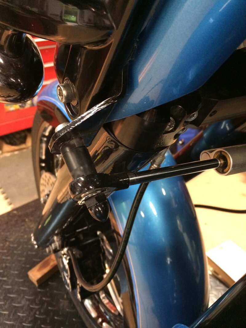

I put a 21" wheel on, so I put 9 degree trees on, per the chart on HHI's website. I bought from them, didn't know I could get them cheaper from Papa Z. Anyway, the damper touched the right lower fairing at full left turn. I used a 1" longer bolt on the left side of damper(the end that mounts to fork) and it clears.
Between the skinnier tire, and the new trees, she steers nice and easy. By that I mean less effort.
And another unforeseen benefit is that with those 9* trees, the diameter of the turning circle is about 6 feet less.
That part is nice...we all know how sharp they don't turn at crowded rallies...:laugh:
Here's all I had to do to make the damper fit. Found a 1" long chrome bushing that fit over the longer bolt. I just wrapped a little black tape around it.
Actually, I put on the 9* but the way HHI explained it to me it was a 3* from HD plus the 6* added up to 9*. They took it off because HHI recommended removing it, or so the dealer said that installed it, otherwise a bracket would have to be made to retro-fit it.
