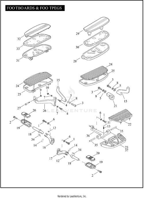

I know this is a crazy question but does anyone know of a kit that raises the driver floorboards? I am not talking out but up. Vertically challenged rider is asking me. I know it can be done but figured I would see if someone has done it before me.

How much higher do you need to go? You may be better off fabricating something to replace or raise the floor board rubbers on your existing floorboards.
You would probably have to design your own mount brackets, I have not seen anything that would move them up for late models
Older touring models had an adjustment to move the boards up a bit, tho they will not work on late model frames
#26 in this picture

Have to agree with JTJersey. Could a cut to fit a piece of wood for floor board (whatever thickness you want) remove rubber insert and bolt down. Glue rubber to top of wood. Could shellac wood from elements. Just a suggestion.
