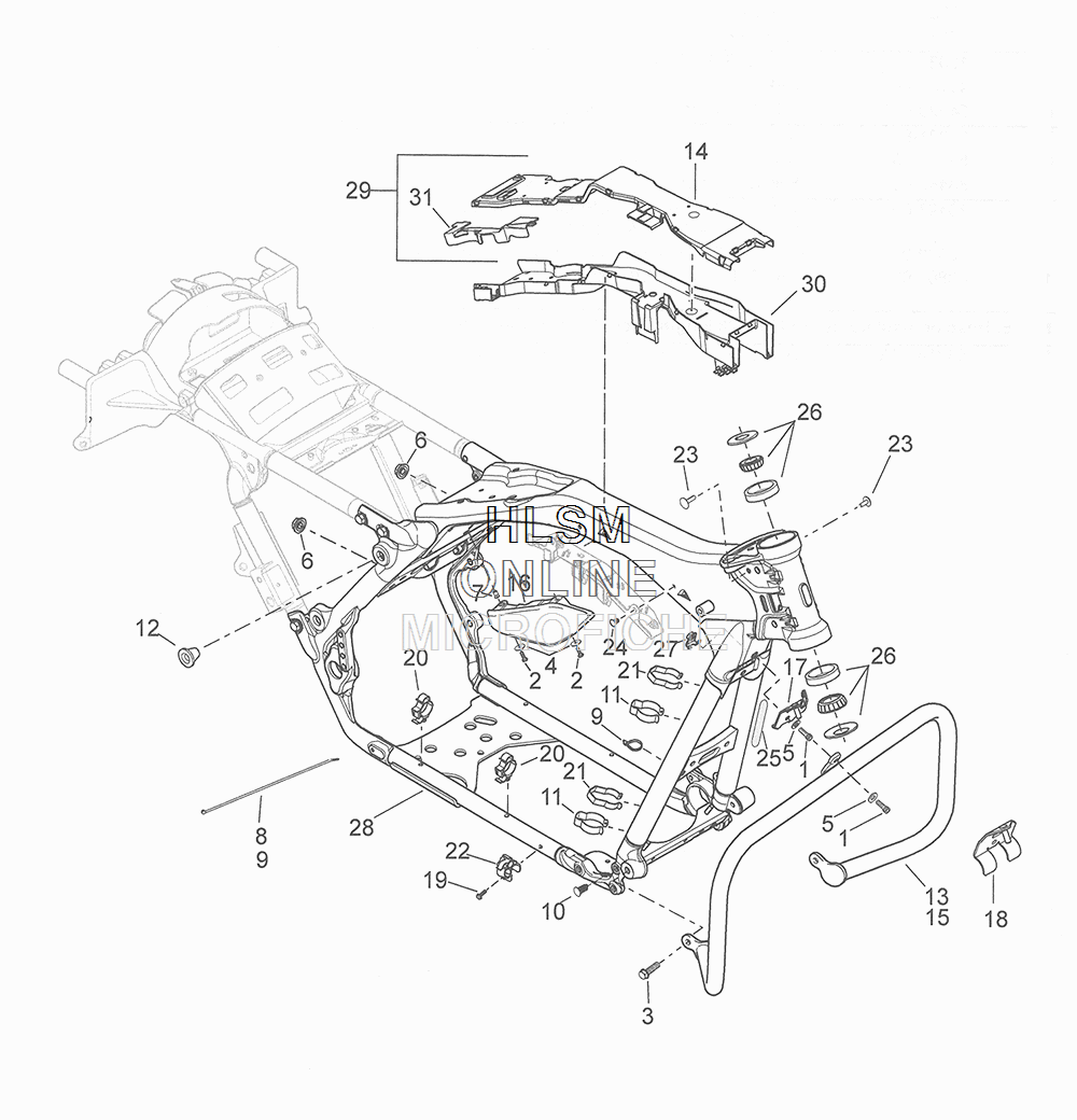

IMO HD should have run the wires thru the electrical caddy under the tank
#30 in the diagram

# 7 is the coil Pete
