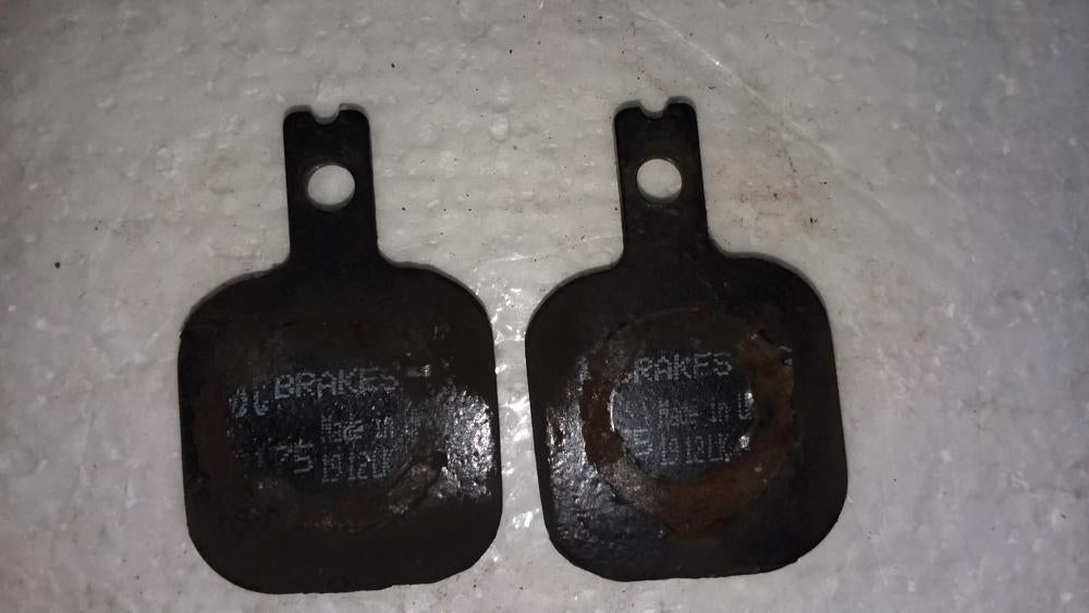

Hell-o everyone. New here. I live in Cleona, Pa. That's 10 miles east of Hershey, Pa. Retired state ride inspector for HersheyPark. I ride a 2003 Honda Goldwing CSC Trike. I am trying to find the rear brake pads. There are four pads for each side. They are small square brake pads. If anyone can help me to locate the brake pads that would be awesome. Ocean City Maryland Bike Week is approaching fast and i need to replace them. I can replace them myself, i just can't find them anywhere. Thanks

Do your pads look like this? If so the parts are EBC [FONT=&quot]EBC FA175 pad[/FONT]
20180810_185709-jpg.300747
Agree with sandman. I just ordered a set a few weeks ago direct from CSC. 8 pads total, enough for both sides. About $60 plus shipping. Had them in about 3-4 days from order date.
Gary, welcome to Trike Talk! Like other stated, call CSC. They will shipped them directly to you. Cost is $60 + shipping... just replaced my brakes on our CSC trike. Had them the next day.
