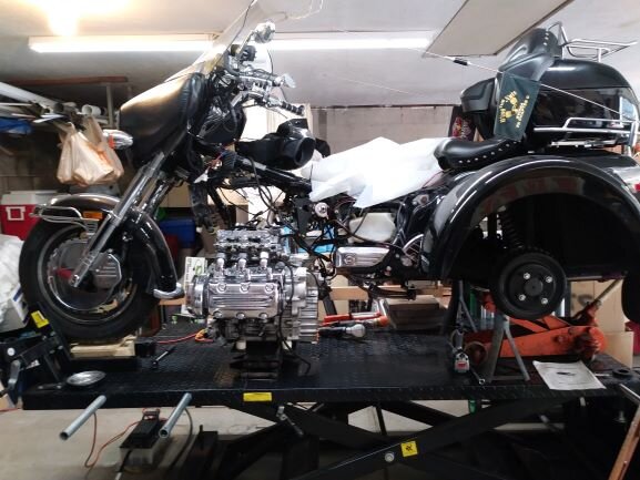

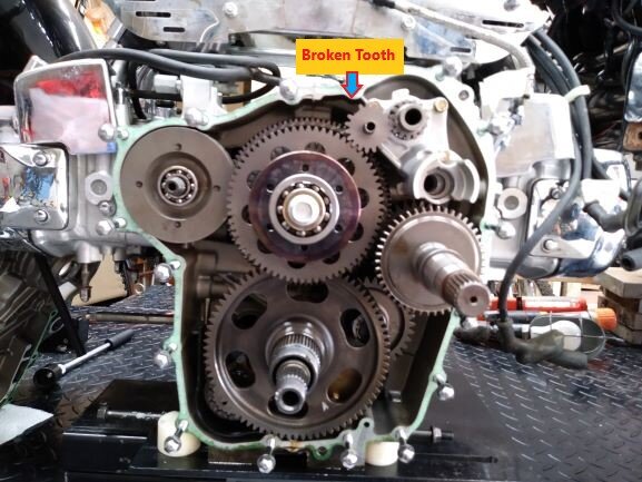

I have been working over the winter months restoring my 1999 Valkyrie Trike. 10 years ago (2009), the engine 1520cc, in my Valkyrie Trike suffered a hydro-lock fuel cylinder problem, (common Valkyrie problem) a fuel leak into one or more cylinders, which when I attempted to start the engine, the starter motor broke off a tooth on the intermediate gear between the starter and the starter/clutch gear. I have never done any internal engine work and now I had to remove the 260-pound engine to repair the broken gear. In 2009 an independent Honda mechanic wanted $2000 plus parts to repair the engine and he would only work on it when he had free time. He said 3 to 6 months to fix it. It was riding season, so I parked the Valkyrie and purchased a new left-over 2008 Goldwing (level 3) with a 2009 Motor Trike kit.
Now 10 years later I got out the Honda shop manual, put the Valkyrie on my trike lift and started to remove the engine. I drained the antifreeze and oil, I then removed the seat, fuel tank, air box, radiator pods, radiator hoses, radiator, thermostat, battery, exhaust, starter, alternator, spark plug wires, clutch line, throttle cables, choke cable, and drive shaft. Next, I remove the engine (260 Lbs.), 6 carbonators, the clutch case, then the clutch. Next came the back-engine case and now I could see the broken gear. I was told that I had to replace the gears on each side of the broken gear, because they could have been damaged by the broken gear. To remove the gears on each side of the broken gear, I had to grind out the 3 locking nuts that were staked into the 3 different shafts that held each gear in place. To work on the engine, I needed to purchase all the special Honda tools listed in the shop manual. Oh, I did find the broken tooth in the bottom of the engine case.
Time to get the new engine parts and start replacing the 3 gears. New parts were clutch gear, intermediate gear, starter gear, shaft lock nuts, seals and gaskets. After I replaced the gears and torqued the lock nuts, I reassembled the engine and then installed it and reassembled everything that I had to remove to get the engine out.

Bike on my lift, jacked up and engine removed.
With what I replaced I should have "almost" a new bike.
