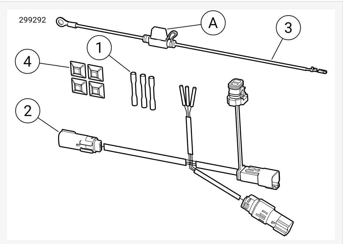

Bought the two outlet accessory plug from Harley.
Found the plug in behind reverse solenoid.
Has a battery wire, with fuse included.
What does the battery wire do?

Without the part number of the accessory plug you purchased it is hard to know the wiring. Battery wire probably supplies power to the accessory plug and the connector plug provides switching to ground through the CANBUS system if you have a newer trike. Did the accessory plug come with instructions?

part# 69201599a kit-harn/wng elec.connector,access.
I needed an accessory connector to connect heated seat
harly hammock
obviously, not in a big hurry right now, but, as I stated, typical harley instructions ane not easy to follow. I think the instructions indicate the included battey lead is to be spliced to the orange/white harness wire, for switched operation.
I'm sure someone has installed this before, as it fits lots of bikes.
I can ask dealer next week, just had time this weekend to install it
Harley changed the Electrical Connection Harness Kit for 17-Later Touring and Trikes

Item #3 in the Electrical Connection Harness Kit is the Fused 1/4" Ring Wire Harness w/Fuse Holder. The Kits Installion Instructions tell how and where to install its Terminal End into your onboard Accessory Connector Plug. The Ring End will then provide the Electrical Power to the Harness for the accessories you connect direct from the Battery.
A Helpful Video
This video is much better than Harley's written instructions at explaining and showing how to insert the pin style end of your Ring Wire Harness into the M8 Accessory Connector. It also addresses the three different electrical connections that can be made off the Harness Kit to add new accessories.
