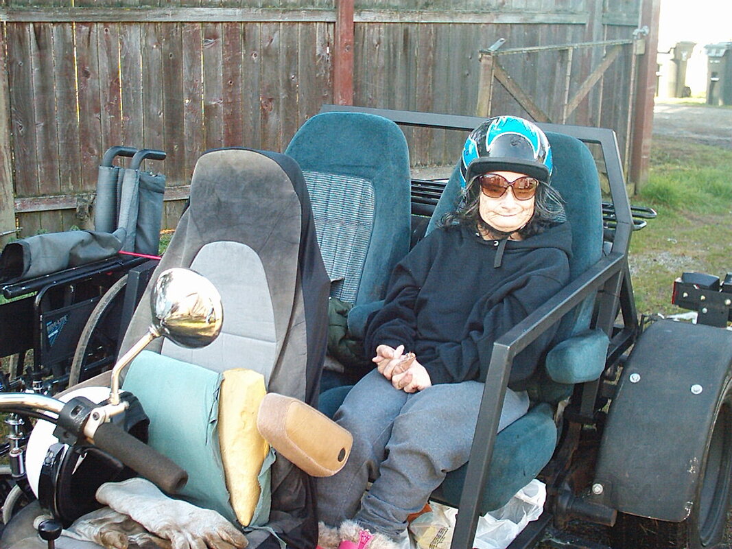

I am in the finishing stages of building a three person trike. I realized early on that the trike would need to be longer to seat three. I didn't want my family sitting two feet higher than I would be so they would be blown around by the wind all day and the rear seats easy to get in and out of. I did a lot of thinking on how to get the rear seats down to the same level as the drivers seat and also wanted them to have room for their feet so they wouldn't be cramped. Taking all of that into consideration I built the trike with a long wheelbase and it all worked out fine, it steers good and goes down the road straight and is very comfortable and safe for everyone. It has a right foot gas pedal and brake, a left foot clutch, a center shift and a right hand front brake lever on the handlebars. The gas tank is directly behind the rear seats. It's drives like a VW bug with handlebars instead of a steering wheel. I have some pictures posted. It took a lot of extra work to build it the way I did but it was worth the effort. You family will thank you.ThumbUpIM000923.JPG
I am in the finishing stages of building a three person trike. I realized early on that the trike would need to be longer to seat three. I didn't want my family sitting two feet higher than I would be so they would be blown around by the wind all day and the rear seats easy to get in and out of. I did a lot of thinking on how to get the rear seats down to the same level as the drivers seat and also wanted them to have room for their feet so they wouldn't be cramped. Taking all of that into consideration I built the trike with a long wheelbase and it all worked out fine, it steers good and goes down the road straight and is very comfortable and safe for everyone. It has a right foot gas pedal and brake, a left foot clutch, a center shift and a right hand front brake lever on the handlebars. The gas tank is directly behind the rear seats. It's drives like a VW bug with handlebars instead of a steering wheel. I have some pictures posted. It took a lot of extra work to build it the way I did but it was worth the effort. You family will thank you.ThumbUpView attachment 19530

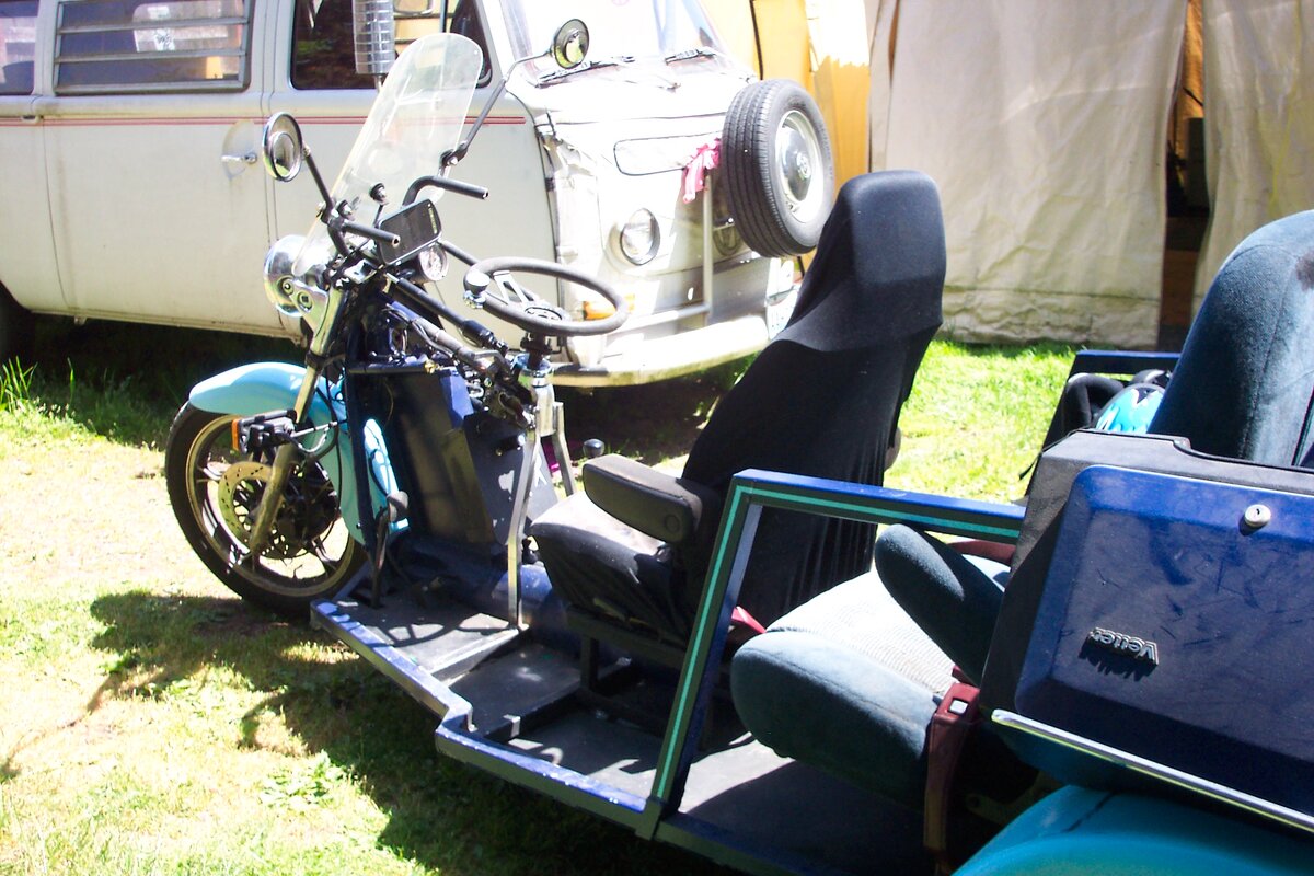

Thanks. I have had to do some major modifications since those pictures. It's a long story but I was persuaded to put a steering wheel on the trike. It has a VW steering box, I had to plumb the front brakes into the VW master cylinder and do some re-wiring but it turned out fine. Now it steers like a car with power steering.ThumbUp100_0993.JPG
