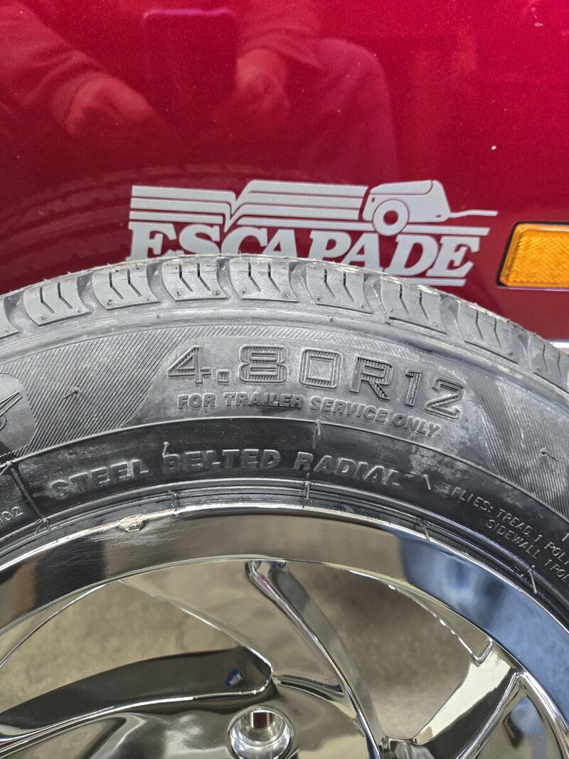

Ordered a pair of Taskmasters 4.80 -12 radials from etrailer. 81 mph rating. Wanted 4 ply for lower payload but could only get the 6 ply radials in that size. Never heard of these tires before but about 7 years ago ordered a pair of tires mounted on aluminum wheels from etrailer.
You learn something new everyday. I had never heard of 4.80R12 radial trailer tires before. I have heard of 145R12 radials that are supposed to be same size as the 4.80-12 bias ply. The reviews seem good. Make sure to do a follow up in these.

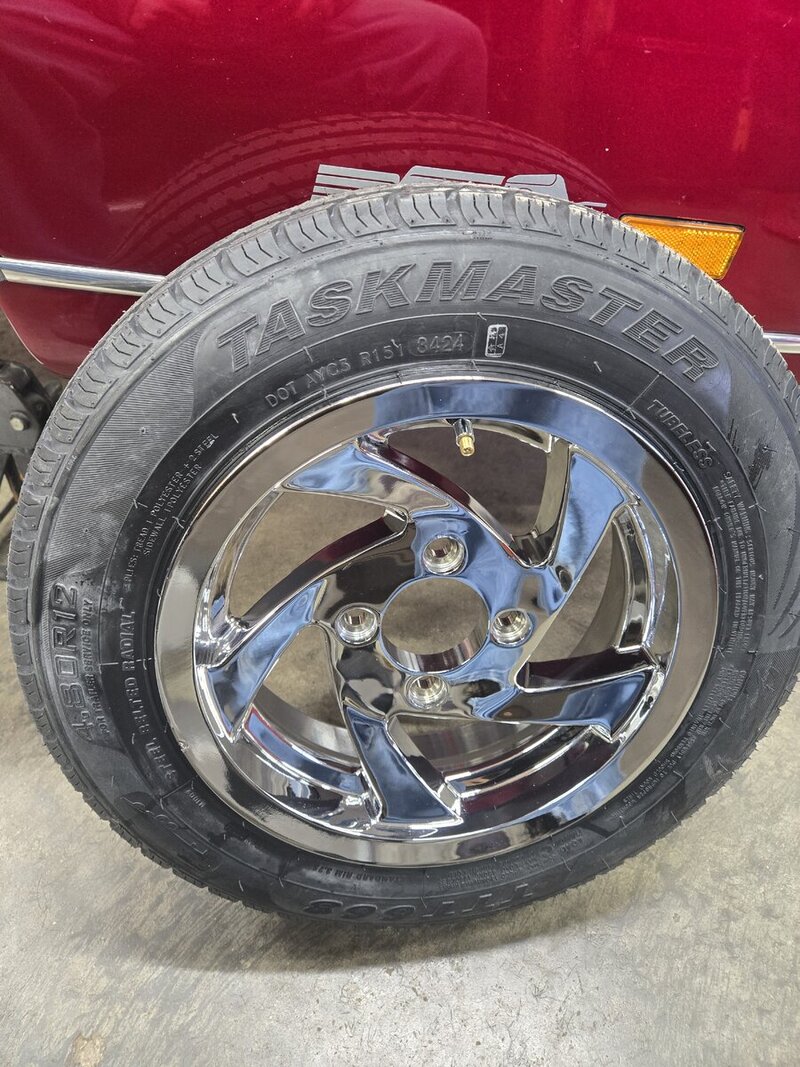

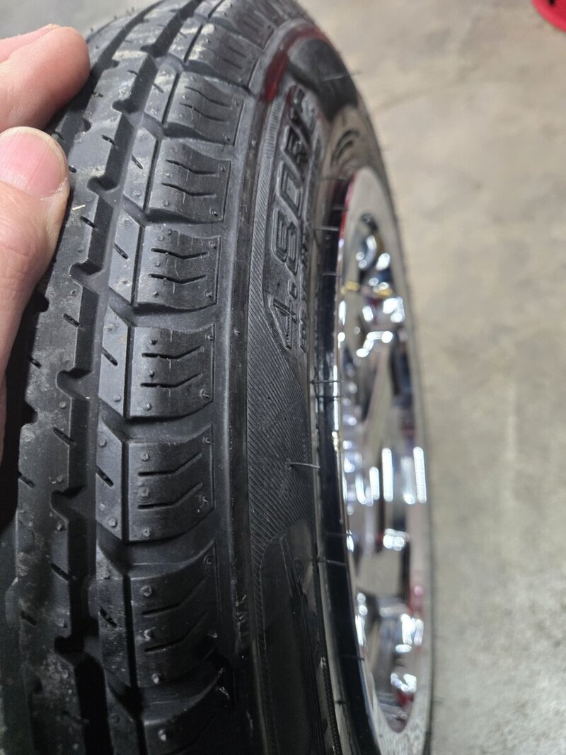

Got new Trakmaster 4.80-12R installed. Only thing I don't like is they don't pop out onto rim like my old Carlisle bias did. They seated nice & mounted them by hand fairly easy. Yet to do road test with them. Speed rated to 81mph. 6 ply 990 lbs load.20250328_112846.jpg20250328_112813.jpg20250328_112917.jpg
Brian did you lube the tire bead with a soapy water before putting the tires on the rim? If not get some mix down around the rim bead and may I suggest that you remove the valve from the stem inflate the tire until the bead fully seats onto the rim. The tire bead is hung up on the rim bead edge and needs to get fully seated.
Yep lubed with tire prep lube. They're still holding air
Good catch! I agree, the bead has to be fully seated or it can be a major hazard.
Brian yes it will hold air until either it has a heavy load on the tire that it will flex and will force the bead of the tire off the small area of the rim or you hit a significant bump or pothole that makes the bead pulls off the rim surface. The bead NEEDS to be seated all the way on the rim.
