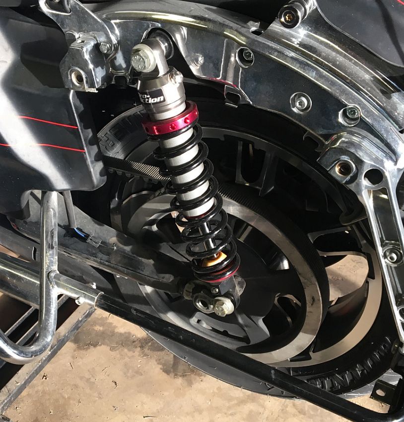

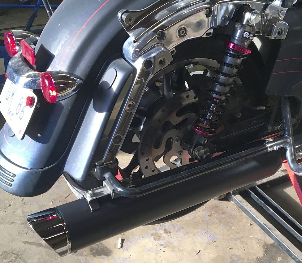

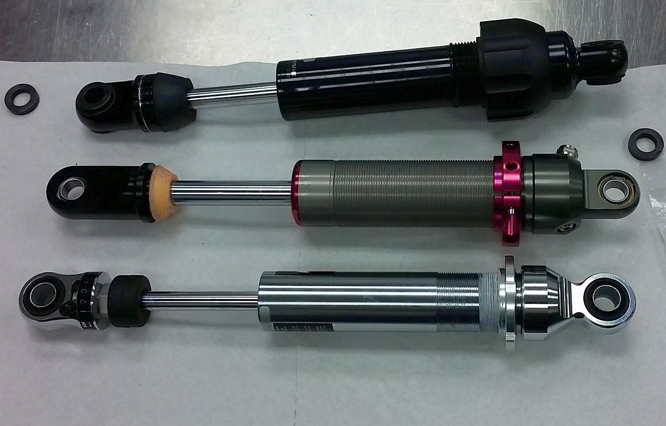

We've been spending quite a bit of time testing different suspensions over the last 30+ days.
Here is a photo of a few of the shocks that we've been testing. The center one is a Pro-Action.
Testing the spring weight-
The next two photo's are Pro-Action Shocks mounted on a Street Glide.
Sorry, I have not yet taken a photo of the Pro-Action on the Tri-Glide, but here is a photo of a different coil-over shock on the Project Tri-Glide.
