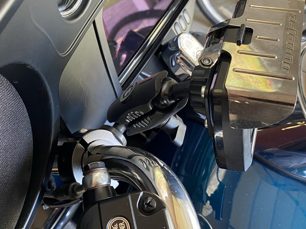

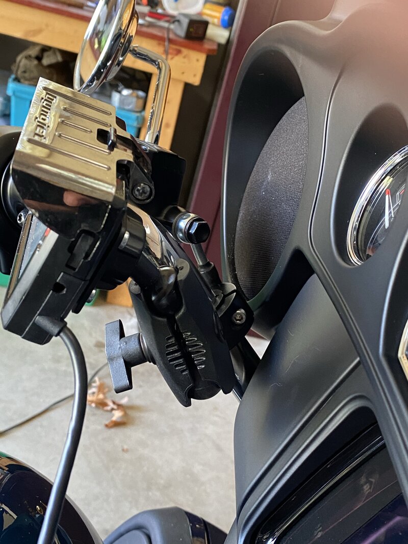

I got my new license for my PV hooked it up, dropped in a stock improved tune, runs better, seems to have the same mileage, got a little over 250 miles on since. With the stock bars I couldn’t get it to mount the way I wanted, so I went with an Arkon mount, mc25mm17 system. Comes with a 17mm ball for the PV mount. 785A950D-90B8-4C1E-B4C1-1DBC410F1A33.jpeg0E6DD38F-F3E4-48F8-BDFE-7B7F92E4B1D0.jpeg
