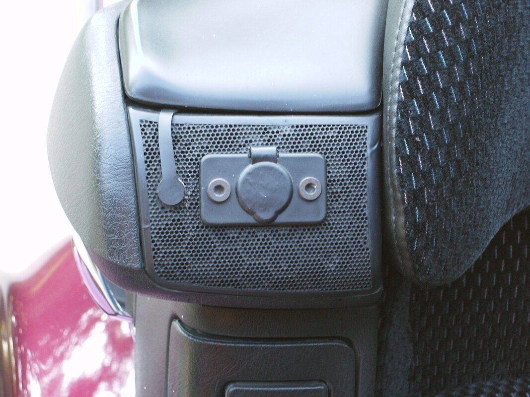

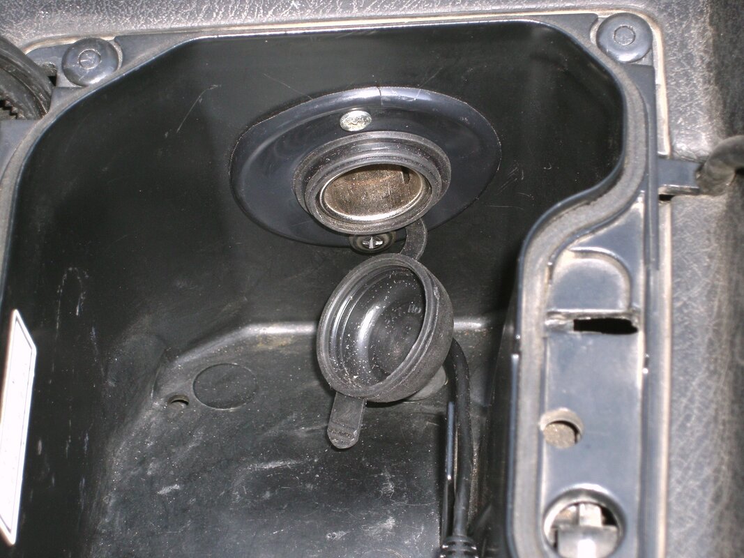

We have a 2004 GL1800. I put a port in the usual place, the left pocket. I seem to remember it was marked on the box where to drill. IMAG0025.JPG

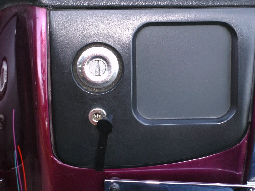

I also put a "quick connect' port under the lock for the right pocket for the heated jacket liner. This kind of connection is used for Gerbings, Warm & Safe, Harley, Firstgear and most other heated gear:
2004 Wings didn't come with rear speakers, we have helmet speakers so I added a quick connect and a cigarette style port where the right speaker would go: IMAG0021.JPG

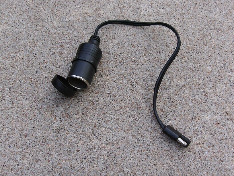

I have a battery charger pig tail hard wired to the battery, and the plug end lives behind the seat. I also have a cigarette plug adapter so I can connect to the battery without having to turn the ignition on.
